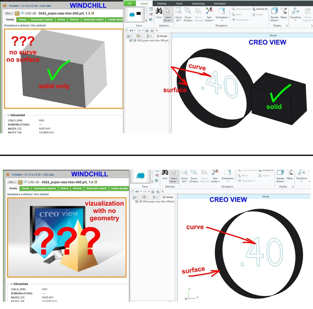

Hola, why unable to see surface or curves on WCH detail page even Creo View can open vizualization OK?

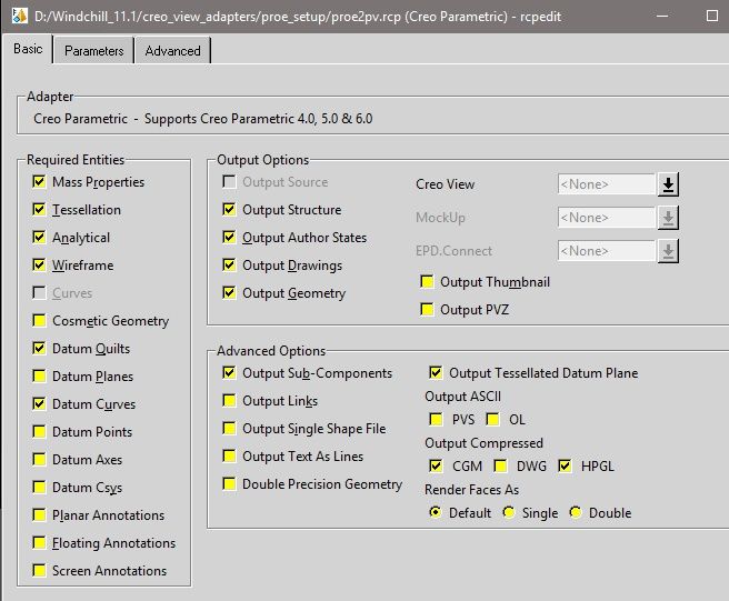

This is my RCP setting on the server (curves and quilts allowed)
Think vizualization is OK so Creo View shows everything but why WCH refusing to show it as well?

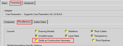

  • 3D surfaces (Quilt geometries) by default get converted as datum entities from Adapter for Creo Parametric (PROE Worker). Datum\Construction geometries are are also not supported for thumbnail generation. One can convert 3D surfaces are quilt geometry by un-checking "Quilts as Construction Geometry"option:
Hope this helps.
Hope this helps.

"Not supported" is not a solution. Think it would be easy to implement when CreoView is able to show it so why not WCH... I have created new WCH idea here
