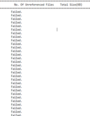

Version: Windchill 13.0
Use Case: While running the unreferenced file check from WinDU the txt file has no of unreferenced files as Failed. What does this mean ?
Description:

Does the number of failed lines correlate with anything like the number of folders you have? A good place to look deeper would be the methodserver logs at the time of run to see if it threw an error. I have never run this task before but I think it would require that vaults are healthy, validated and mounted. Clearing our unreferenced files is a periodic task that should be done to free up HD space.

Note that removal of unreferenced files is done at the UI level but there exists a command line tool as well.
Provide the complete Methodserver log generated during running the WINDu task will be helpful for understanding the report
