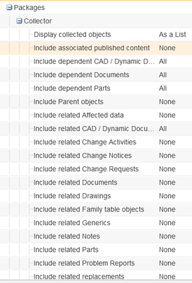

I would like to mention that you are talking about Windchill Service Information Manager
Also it would be nice to share more context about your case.
Where do you have the issue? Package? what kind of collector are you talking about?
Share some screenshots what is not clear to you?
Reference objects can be whatever you can imagine in the Windchill system.
Depends on links. CAD Document Drawing/Assembly/3DPart - WTPart eBOM/mBOM - WTDocument - ProcessPlan - Operation - Change Request - Change Notice - Change Tasks - Promotion Requests and so on.
There are many references you can collect.

I am fairly new to Windchill.  Our company creates ICNs and DMCs on Windchill for digital publishing. For a particular publishing, I want to include only the ICNs and DMCs that are required. So for a specific publishing, I created a PMC and added the necessary landing pages or DMCs to it.
On the package, I  added the PMC as the content of the package. The landing pages themselves contain the referenced DMCs and those referenced DMCs would contain DMCs or ICNs that are referenced by them.  Why question is would I need to manually add the referenced DMCs to the package or are automatically add to the package once the PMC is added?
OR is there something that I can do on the Packages action in the Set Preference utility to make that happen?

Hi @KF_10432003
If you can find your super parent object type in the preference collector then you can set to collect it.
If not, it is a pity
