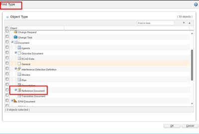

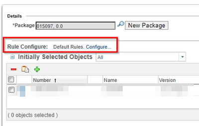

When creating packages we run into the fact that in the collector all underlying documents are added to a package. This used to be OK, but recently we started using Referenced Documents as well. The problem I'm facing now is that when I create a normal WorkPackage using the default settings in Windchill, the system includes all documents, so also the reference documents:

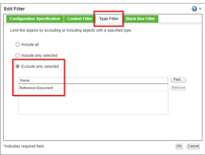

But I would like to have it include all documents, except the reference document type.
I know I can manually exclude it from the collection rules using Edit Filter and then Type Filter
However this is a manual action everytime and I think there should be a better way.
