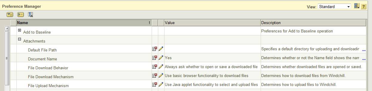

Some of our users are receiving the following error message from Internet Explorer when trying to upload a file into Windchill: The operation: "getCacheDescriptor" failed. I don't see anything in the Windchill logs. Is this a browser issue? The environment is Windchill 9.1/Windows Server 2003/Oracle/JRE 1.5.0_16. Any ideas would be much appreciated. Thanks.

had the same problem. Found the solution in the ptc problem database (TPI 143667):
Clear all the Java cache on the client.
To clear client Java cache go to Start-> Settings->Control Panel->Java (Java Control Panel)
Under Temporary Internet Files -> Click Settings and then click Delete Files.
Make sure Applications and Applets check box is selected.
Alternative:
Use Browser upload instead of Applet upload by changing the upload preference from Preference
Manager
In my case only the alternative worked
Bye
Wolfgang

-> Preference Manager -> Attachments -> File Upload Mechanism

I did this setting and it works -> Preference Manager -> Attachments -> File Upload Mechanism >>> Use browser
