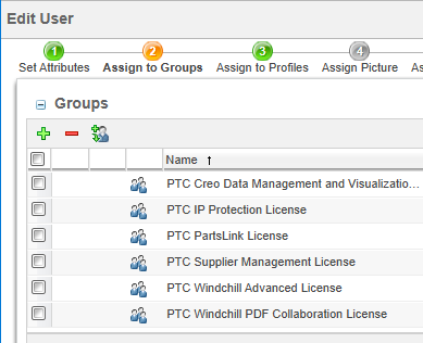

One option is to check your licenses:
https://www.ptc.com/en/support/article/CS282719
Just asking, are you connecting through Creo or are you viewing workspace via outside browser?

Do you have write permissions to that con text/folder in Windchill?
I dont know what write permissions mean, but I've been able to check in work previously. Not sure if that answers the question,
BenLoosli
(To:MB_11565484)
Each folder/context in Windchill can have different permissions. Is the folder you are trying to check that object into one that you have saved other parts in it before?
I have not saved parts in that folder before since I created it for the assembly.
However, in another folder where I know I have been able to save parts, the same problem occur with the check in not being avaliable.
So I guess my permissions have changed?
How do I check my licenses? I've seen that it could be the problem but havent found a way to check it.
Yes, I'm connecting to windchill via Creo.
If you are not an site or org administrator, as them to check your account in the Participant Administrator on the Site or Org utilities page. You should see licenses as groups assigned to your account:
You want to make sure you have Creo Data Management (which I think you do since you can create workspaces) and Windchill Advanced which allows WTPart creation. I've also seen issues if you were added to the license exclusion group.
I'm probably not admin, but if I am, how do I get to that window to check?
You would go to either the Org or Site Administration pages. One of these two icons would be visible to you in the Navigator pane. If you do not see it, you need to work with your admin to diagnose.
It was indeed an expired license. We called our distributor and it has been renewed and all functionality is back. I can check in my work again.
