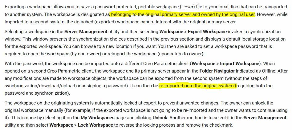

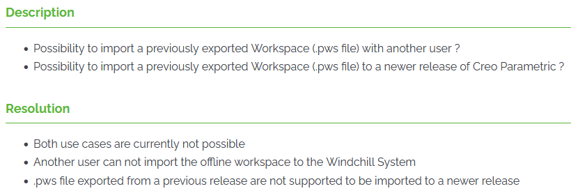

Based on these two articles, I would guess the answer is 'no'.  The exported workspace can only be imported to the same version and only by the same user.
https://www.ptc.com/en/support/article/cs64954
https://support.ptc.com/help/wnc/r12.1.0.0/en/#page/Windchill_Help_Center/cadx/CADxSrvrWspMgmtWspOfflineFunctAbout.html#

It is clear,
The safer solution is to upload.
