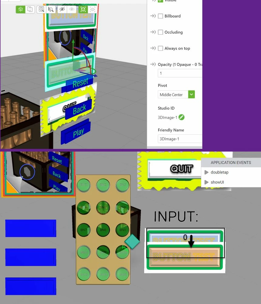

How can we make a 3D Widget on HoloLens visible in front of me every time ?
The goal here is to get a some UI containing 3D Widgets (3dButtons , 3dImages , 3d Labels and 3d Models) in front of current HoloLens view. For example after saying "show UI" the UI elements should appear in front view e.g. distance of 1,5 meters. Example:
In the Tech Tip article "How to create a custom button pressable on HoloLens device?" is shown how to create a custom UI button. Now  based on the example of this project   the functionality will be extended by adding the possibility for dynamic display of the UI elements in front of the current view.
To be able to move the elements in front of us we need to calculated the current view matrix and the inverse matrix  of if.  For this goal we need to prepare some mathemtics function like , matrix inverse calculation, marix multiplication , matrix with vector multiplicaiton, vector product und dot vector product ... etc. When we sear in Internet there a lot of sources where we can find the informormation how to implement such mathematical tools.
  • The first steps is to calculate the view matrix - e.g. some code:

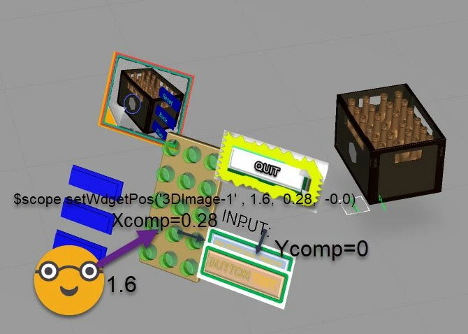

  • We already calucalted the rotation and now we need to calculate the x,y, z postion. This will be a point which is in front of use - along the gaze vector with particular distance and then x, and z corrinates of the view X and View Y vector:
$scope.setWidgetProp( wdgName, 'rx', rad2deg(EulerAnglesInv[0]) )
$scope.setWidgetProp( wdgName, 'ry', rad2deg(EulerAnglesInv[1]) )
$scope.setWidgetProp( wdgName, 'rz', rad2deg(EulerAnglesInv[2]) )
var eye_dir_norm = vec_normilize($scope.eyedir)
//projected to normal
 var eyeZaxis 	= eye_dir_norm;
 var eyeYaxis 	= vec_normilize($scope.eyeup);
 var eyeXaxis 	= neg_dir(vec_normilize(vec_product(eyeYaxis,eyeZaxis)))
 var newCalc = [];
 // here it will translate along the eye_dir and move in x and y axis
 for (var i=0; i<3; i++)
 		newCalc[i]= $scope.eyepos[i] + disScale*eye_dir_norm[i]
 + Xcomp*eyeXaxis[i] + Ycomp*eyeYaxis[i];
 //correction of the translation to the view plane in distnace of disScale
 $scope.setWidgetProp( wdgName, 'x', newCalc[0] )
 $scope.setWidgetProp( wdgName, 'y', newCalc[1] )
 $scope.setWidgetProp( wdgName, 'z', newCalc[2] )

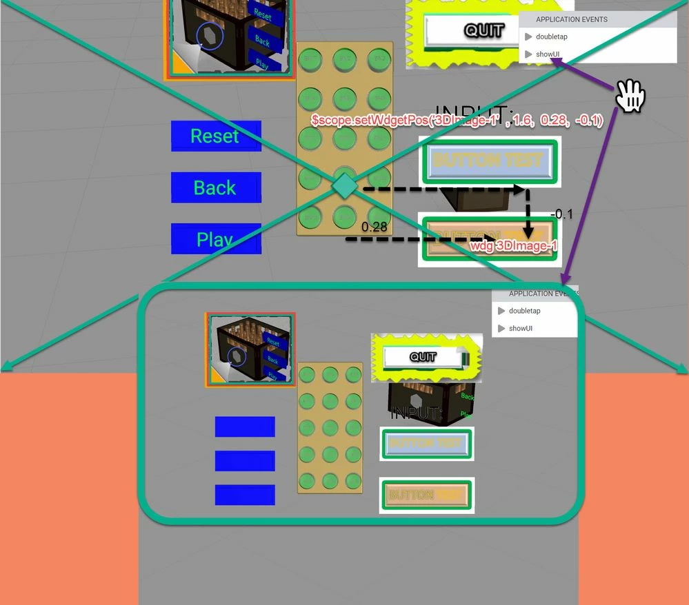

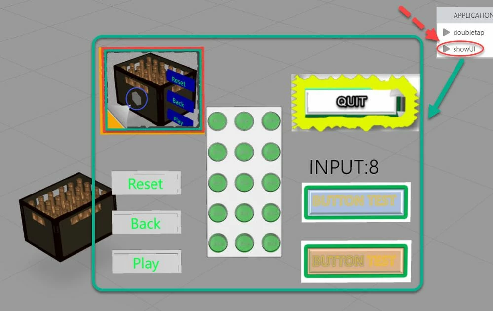

So that now we can display the UI widgets with some calls like this:
 $scope.setWdgetPos('ShopingCard3DImage', 1.8, -0.25, 0.35)
 $scope.setWdgetPos('3DImage-1' , 1.6, 0.28, -0.1)
 $scope.setWdgetPos('3DImage-2' , 1.6, 0.28, 0.05)
 $scope.setWdgetPos('3DImage-3' , 1.6, 0.28, 0.3)
 $scope.setWdgetPos('3DButton-1' , 1.6, -0.25, -0.1)
 $scope.setWdgetPos('3DButton-2' , 1.6, -0.25, 0.0)
 $scope.setWdgetPos('3DButton-3' , 1.6, -0.25, 0.1)
 $scope.setWdgetPos('model-2' , 1.7, 0, 0.1 , 1)
 $scope.setWdgetPos('3DLabel-1' , 1.6, 	0.25, 0.14)
In this article I provided a demo project which is attached to this article as zip file. I attached also the javascript math function which I used.
 Where we have the widget name, distance along the gaze vector from the device and the X and Y position /X and Y view vectors /screen
  • To be able to get the device  gaze , up(y) and the x vector we can use the 'tracking' event:

I created a demo project which is one possible example showing how we can implement such functionality. The sample project is for the HoloLens - I tested with on preview mode and on the  HoloLens 1 device and it was working fine. (- zipped project with password "PTC" - please, unzip it and import it to Studio)
A note about the attached file:
- the file project-"HoloLens3dFlexibleUI-article_ExampleProject.zip" should be unzipped to HoloLens3dFlexibleUI-article.zip - which is a project file for Vuforia Studio - demo project and could be imported in the Vuforia Studio UI. To unzip the project-example.zip you need a password simple: 'PTC ' - in capital characters
-the file: myMathFunc.zip contains the used mathematical function definitions (zipped js file) . The javascript file is also contained by  the Studio project/ upload folder.

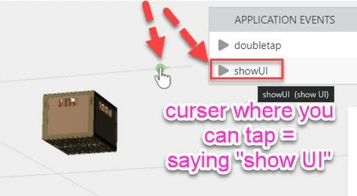

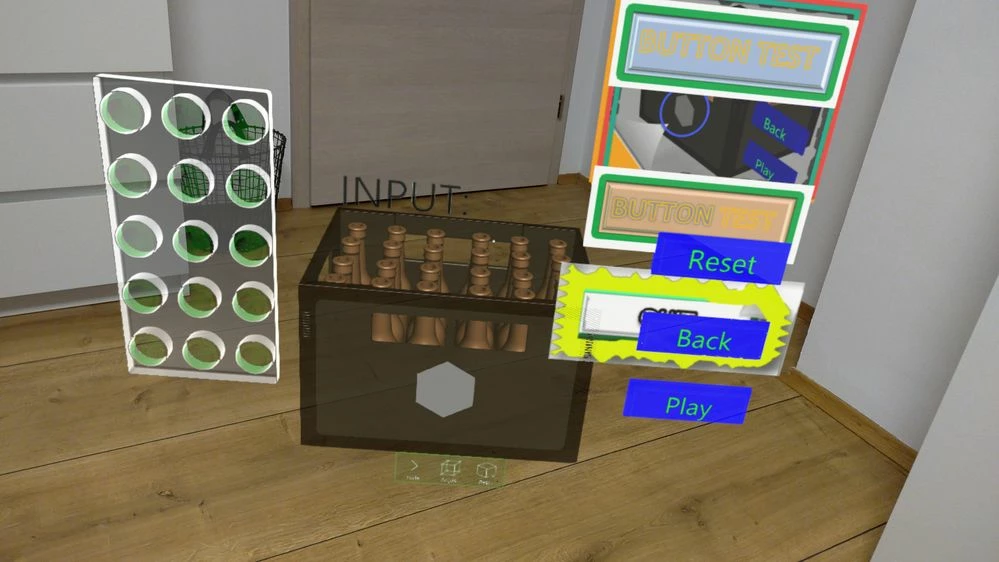

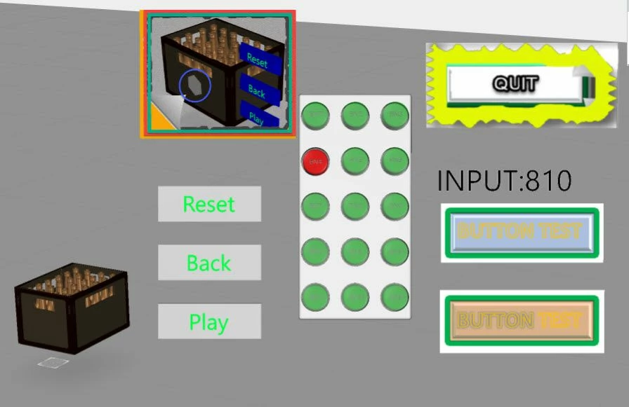

When we test the project:
Where we see in front in the middle a cursor where we can tab or we can say show UI to display the UI:

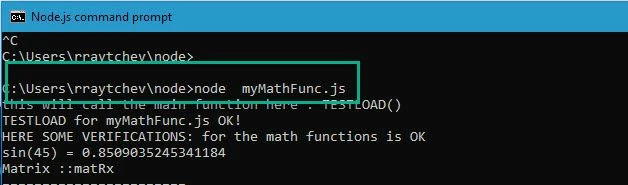

I attached a new version of the  myMathFunc.js (newVersion2-myMathFunc.zip)where rotation function and the verification was improved
Now the library could be verified by call in Node.js
..\node>node myMathFunc.js
TESTLOAD for myMathFunc.js OK!
HERE SOME VERIFICATIONS: for the math functions is OK

Row[3]=:: m[3][0]=0.0000; m[3][1]=0.0000; m[3][2]=0.0000; m[3][3]=1.0000;
Vector[length=6] :: TESt @ matRz
vec[0]= 0
vec[1]= 0
vec[2]= 59.99999999999999
vec[3]= 0
vec[4]= 0
vec[5]= 0
matTr=ggetTransMatrix(1,2,3)
Matrix ::matTr
Row[0]=:: m[0][0]=1.0000; m[0][1]=0.0000; m[0][2]=0.0000; m[0][3]=1.0000;
Row[1]=:: m[1][0]=0.0000; m[1][1]=1.0000; m[1][2]=0.0000; m[1][3]=2.0000;
Row[2]=:: m[2][0]=0.0000; m[2][1]=0.0000; m[2][2]=1.0000; m[2][3]=3.0000;
Vector[length=6] :: TESt @ matTr
vec[0]= 0
vec[1]= 0
vec[2]= 0
vec[3]= 1
vec[4]= 2
vec[5]= 3
trfTestMat=transpondMat(mult(mult(transpondMat(matRz),mult(transpondMat(matRy),transpondMat(matRx))),transpondMat(matTr)))
Matrix ::calculated:: trfTestMat
Row[0]=:: m[0][0]=0.3536; m[0][1]=0.6124; m[0][2]=-0.7071; m[0][3]=1.0000;
Row[1]=:: m[1][0]=-0.6929; m[1][1]=0.6793; m[1][2]=0.2418; m[1][3]=2.0000;
Row[2]=:: m[2][0]=0.6284; m[2][1]=0.4044; m[2][2]=0.6645; m[2][3]=3.0000;
eulerOutput=transfMat2Euler(trfTestMat)
eulerOutputDEGREE=tconvEuler2Dec(eulerOutput)
Vector[length=6] :: TEST @ EulerVecDeg at LOAD
vec[0]= 0.3490658503988659
vec[1]= 0.7853981633974483
vec[2]= 1.0471975511965976
vec[3]= 1
vec[4]= 2
vec[5]= 3
Vector[length=6] :: TEST @ convEuler2Dec:: eulerOutputDeg at LOAD
vec[0]= 20
vec[1]= 45
vec[3]= 1
vec[4]= 2
vec[5]= 3
trfTestMat1=getTrfMat(20,45,60,1,2,3)
Matrix ::calculated:: trfTestMat1
eulerOutput1=transfMat2Euler(trfTestMat1)
eulerOutputDEGREE1=tconvEuler2Dec(eulerOutput1)
Vector[length=6] :: TEST @ EulerVecDeg1 at LOAD
vec[3]= 1
vec[4]= 2
vec[5]= 3
Vector[length=6] :: TEST @ convEuler2Dec:: eulerOutputDeg1 at LOAD
vec[0]= 20
vec[1]= 45
vec[3]= 1
vec[4]= 2
vec[5]= 3
Library test on LOAD finished!
Time:: 02:16:56 PM
finished TESTLOAD Version ::version 1.003 08.April 2020
April 15, 2021
This is a great tutorial!
I tested it on the HoloLens 2. It works in the browser preview, but unfortunately not on HoloLens 2. What am I doing wrong?
I need a UI solution for the HoloLens 2.
April 15, 2021
Here is a picture of how it is displayed at the moment.
April 16, 2021
Hello  @Lucas ,
thanks for your feedback!
So far I see the picture (it is HoloLens 2? device right? ) and it is invertet - means that  you will see the backside  of the UI (assembly which implements the 3d buttons panel - is inverted and other things are working - on the correct plane but also moved.
Could you please, clarify. I did created it some time ago and need to check more detailed to understand what is going wrong on the HoloLens 2. My first guest is that we need to rotate the 3D objects about 180 degree. I remember that after some update there was a problem and the project was not working (also in Preview mode) - so I did recreated it and maybe there are some mistakes. I test that it worked generally on preview without further to check if everything is on the correct place also on the eyewear device
How do you want to use this – mean what kind of target (space target, model target or thingmark)
Additionally I want to point that the project was created at time where we did have this functionality on the HoloLens yet. In the meantime, we have new functionality 3D panel which is container for other 3D widgets and it will follow you display and could be pin on a particular location. Maybe it could be convenient to use it
April 19, 2021
Hello @RolandRaytchev,
thank you for your quick reply.
I have worked on the weekend further and dealt with the 3D panel. It would work, but the 3D panel is too far away once it is bound to the field of view. How can I adjust the distance?
I would like to implement some kind of menu with it. The user should be able to open and close it with a gesture. In the menu are then different buttons and displays that the user constantly needs.

$scope.setWdgetPos('3DImage-1', 1.6, 0.28, -0.1)
Can you please tell me how can I determine the correct numeric values when I use my 3D elements? I have seen the function definition but I can't understand how to use these parameters.
In particular, I would like to replicate the tethered/untethered functionality and so understand why you chose "1.6" "0.28" "-0.1" as values based on that 3DImage-1.
Thanks in advance 😊
December 11, 2023
Hi @aletenti ,
this techique in the article is working still but it  was originaly  intented as workaround before there was a 3DPanel widget. So the quesiton was to allign the elements norm to eyevector with distance to the device position.
OK the quesiton is what are your requirements. e.g. There is alternative to use the 3DPanel which is more easy to work for the same task. OK there is 3D assembly used as 3D buttons assembly , the concept here is  also from the time before 3D buttons are availible in the HoloLens , We have all this functionality in the mean time so that I think this techniques is not neccessarly and relevant for the current usage. Remeber that here we use only tap click. Means you gaze the element and then do Air tap. on the current 3D button we have really a finger click on them. OK Air tab is further supported and work. The finger click/tab is possibly only ith the 3D button widgets
But OK let consider how this function work $scope.setWdgetPos()
  • it receive arguments widget name , the disScale Xcomp, Ycomp - coordiante
             In the example
  •  to understand the difference I will use also the example
    $scope.setWdgetPos('3DImage-1', 1.6, 0.28, 0.0)​
distScale is argument for the distance from your possition (device ) along the Eyevector, so larger values will increasd the distance to the plane where the UI will be located.
Xcomp
Ycomp
are x,and y coordinate of the component.
You have to see that the center of your device screen has a normal vector which is the eyevector and this is the x=0,y =0 zerro point if the view plane. The view plane is  flat plane paralell to you device - if iPad then paralell to the iPad screen. And here you need the flat  coordinates in x,y of the component in meter so far I remember , So here is the postion of the 3DImage-1 shift to the right =0.28 and shifted down (minus) -0.1.
So we can see that when we call the showUI it will move all elements paralel to the view plane (through the eyes - if  the device is a tablet then this is  the plane of the screen) . The plane where the element should be displayed is shift paralell to the screen plane in distance of 1.6 m. the center is 0, 0. And 2.8, 0.0 is the element moved to the center , right
