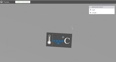

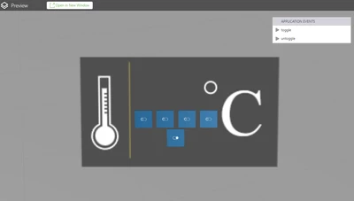

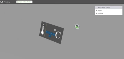

I created a demo project which is one possible example showing how we can implement such functionality. The sample project is for the HoloLens - I tested with on preview mode and on the  HoloLens 1 device and it was working fine. (- zipped project with password "PTC" - please, unzip it and import it to Studio)
A note about the attached file:
- the file project-"HoloLens3dFlexibleUI-article_ExampleProject.zip" should be unzipped to HoloLens3dFlexibleUI-article.zip - which is a project file for Vuforia Studio - demo project and could be imported in the Vuforia Studio UI. To unzip the project-example.zip you need a password simple: 'PTC ' - in capital characters
-the file: myMathFunc.zip contains the used mathematical function definitions (zipped js file) . The javascript file is also contained by  the Studio project/ upload folder.
When we test the project:
Where we see in front in the middle a cursor where we can tab or we can say show UI to display the UI:

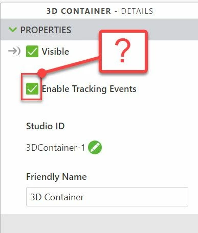

Hi @aletenti , did you set the 3D container property enable Tracking event?
if yes then need to check it furhter....
March 13, 2024
Hi Roland, you are right... I forgot to set that property.... 🙂
Now it works, thank you very much!

Here's some screenshots:
1- initial view
2- 2nd view
3- activated auto-follow
As you can see, all the elements stay linked with the "father".
