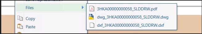

Jul 15, 2025 3:37 AM UTC
Hello @avillanueva
Thank you for the response, I hope you are doing well.
if user wants to download .pdf, .dxf and .dwg then the above method will return these files.
avillanueva
23-Emerald II
Jul 15, 2025 11:08 AM UTC
Is that a question? Yes, what you showed is what the code is getting. You need to write something to retrieve and format the URL for download. What you know on the details page is the object ID of the EPMDocument. From there, the code finds the representations and files contained within returning a URL to that content. That is what you were asking for right?
