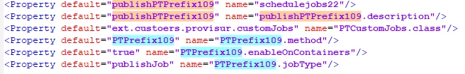

Maybe a better way for me to approach my issue with the community is forget about the Java code first and focus on why I cannot run my custom schedule job in my 'org' context?
I added my entries to wvs.properties.xconf
   <Property default="publishPTPrefix109" name="schedulejobs22"/>
   <Property default="publishPTPrefix109" name="publishPTPrefix109.description"/>
   <Property default="ext.custoers.provisur.customJobs" name="PTCustomJobs.class"/>
   <Property default="PTPrefix109" name="PTPrefix109.method"/>
   <Property default="true" name="PTPrefix109.enableOnContainers"/>
   <Property default="publishJob" name="PTPrefix109.jobType"/>
I then ran xconfmanager -p
when I go to browse / site / wvs job scheduler administration, I see my job listed and if I run it, it will run in context 'site'
When I go to browse / org / wvs job scheduler administration, I do not see my job listed.
The question is Why?
thanks
Mike
February 25, 2020
I think there is a mistake in your properties:
You should have an identical name either publishPTPrefix109 or PTPrefix109.

After xconfmanager -p and restarting windchill services, I tried running my custom job in the scheduler and now I receive the java error ClassNotFoundException.   See below
2020-02-27 07:53:26,078 ERROR [WVSScheduleQueue.SchedulingThread] com.ptc.wvs.server.schedule.Schedulable Administrator - executeQuery(): mQueryClass=ext.customer.provisur.customJobs mQueryMethod=PTPrefix109
java.lang.ClassNotFoundException: ext.customer.provisur.customJobs
Is the error telling me the windchill classpath is incorrect?  mQueryClass appears to show the correct location under codebase as "ext.customer.provisur.customJobs" where the class file resides.   The mQueryMethod has the correct name PTPrefix109.
Thanks.
February 29, 2020
I have resolved my situation with setting up the wvs.properties.xconf file correctly.  Thanks to the reply by froussel_ca and several other links.
Other links helpful include: https://support.ptc.com/help/wnc/r11.2.0.0/en/index.html#page/Windchill_Help_Center/WCCG_BusLogicCust_WCVisualization_CustPublish.html
https://www.ptc.com/en/support/article/CS211115
My corrected wvs.properties.xconf entries are below:
   <Property default="PTCustomJobs" name="schedulejobs22"/>
   <Property default="PTPrefix109" name="PTCustomJobs.description"/>
   <Property default="ext.customers.provisur.customJobs.PTCustomJobs" name="PTCustomJobs.class"/>
   <Property default="PTPrefix109" name="PTCustomJobs.method"/>
   <Property default="true" name="PTCustomJobs.enableOnContainers"/>
   <Property default="publishJob" name="PTCustomJobs.jobType"/>
Schedulejobs22 name PTCustomJobs needed to be in each of the entries below as shown above.  The PTCustomJobs.class entry does require the full path of the class.   This is stated in the documentation just remember to put the actual class name in the entry not just the path name.
