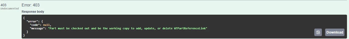

How to create WTPartReferenceLink using Windchill REST Services in Windchill PDMLink
Version: Windchill 12.1
Use Case: Using Windchill REST Services to creating a Referenced By link between a Part and a Document
Description:
I have followed this guide to successfully create a customization to create a WTPartDescribeLink using WRS: https://www.ptc.com/en/support/article/CS285572?source=search
The guide also mentions how to apply the same steps for WTPartReferenceLink, but I am receiving an error and would appreciate some guidance.
URL: POST https://mywindchill.portal.ptc.io:8443/Windchill/servlet/odata/ProdMgmt/Parts('OR:wt.part.WTPart:226444')/References
 "ReferencedBy@odata.bind": "PTC.ProdMgmt.CustomCompanyParts('OR:wt.part.WTPart:226444')",
 "References@odata.bind": "PTC.DocMgmt.Documents('OR:wt.doc.WTDocument:226427')"
The error:
 "error": {
 "code": null,
 "message": "Unable to create entity - Cannot cast wt.doc.WTDocumentMaster to wt.vc.wip.Workable"
I would really appreciate some help resolving this issue.
Attached is my code for this, which was uploaded to "/codebase/rest/ptc/domain/ProdMgmt/v7/entity". I took the working copy used in the tutorial for PartDescribesLink and modified it for this. I must be missing something!
Part of my struggle is that I do not know how to troubleshoot this. I attempted to add logging statements following this guide like so:
var mylogger = log4javascript.getLogger("PTC.mypackage");
mylogger.trace("...");
However, this returns the error "log4javascript is not defined". I suspect there's more to do than what the guide says. I feel like I'm flying blind, I am editing some code with Notepad++ and having to restart the server takes 15 minutes anytime I want to test something.
Perhaps this is an easy fix, but I looked at other related topics for my issue, but no resolution was posted, so any additional help would be very much appreciated!
May 19, 2025 6:39 PM UTC
Here is the solution code that you will need:
PartReferenceLink.js

PartReferenceLink.json
 "name":"PartReferenceLink",
 "collectionName":"PartReferenceLinks",
 "type":"wcType",
 "wcType":"wt.part.WTPartReferenceLink",
 "description":"Part reference link",
 "operations":"CREATE,UPDATE,DELETE",
 "includeInServiceDocument":false,
 "defaultForWcType":true,
 "parent":{
 "name":"WindchillEntities"
 "attributes":[],
 "inherits":[
 "name": "softattributable",
 "version": "5"
 "navigations":[
 "name":"ReferencedBy",
 "target":"Parts",
 "type":"Part",
 "isCollection":false,
 "partner":"",
 "internalNameForDisplayName":"referencedBy"
 "name":"References",
 "target":"PTC.DocMgmt.Documents",
 "type":"PTC.DocMgmt.Document",
 "partner":"",
 "internalNameForDisplayName":"references"
Now you can hit this endpoint:
POST /ProdMgmt/Parts('{PartId}')/References
 "ReferencedBy@odata.bind": "PTC.ProdMgmt.MyCustomPartEntity('{PartId}')",
 "References@odata.bind": "PTC.DocMgmt.Documents('{DocumentId}')"
You can add it to your CCD package by putting the files in this big nested folder structure:
/my_CustomModule/main/resources/rest/custom/domain/ProdMgmt/v7/entity/

Jul 24, 2025 8:09 AM UTC
Hi, I am trying to implement this. After putting the files, I am trying to make the request. I checked out the Part before making the request. Even with checked out part I am getting the error code 403 with following response body.
{ "error": { "code": null, "message": "Part must be checked out and be the working copy to add, update, or delete WTPartReferenceLink"
Also I used the request body as following
"ReferencedBy@odata.bind": "PTC.ProdMgmt.MechanicalPart('OR:wt.part.WTPart:349320081')",
"References@odata.bind": "PTC.DocMgmt.Documents('OR:wt.doc.WTDocument:349319669')"
Is there anything similar you have faced. I would be grateful for any help or suggestion. Thanks
Jul 24, 2025 2:59 PM UTC
Hello,  instead of debugging above (are you using the OID of the working copy?), you might upgrade to the latest Windchill version. The functionality discussed here is now available in standard Windchill:
With Windchill REST Services 13.1.1.0, the Product Management v7 domain has been updated:
◦ Introduced the ability to create a part reference link between an existing part and a reference document.
◦ Introduced the ability to modify an existing part reference link.
◦ Introduced the ability to delete an existing part reference link.
See https://support.ptc.com/help/windchill/r13.1.1.0/en/#page/Windchill_Help_Center/NewandChanged_WRS/wrs_ProdMgmt_domain_13_1_10.html#
