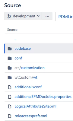

I've been following the posts of the year's on Windchill development and how folks are managing their customizations and their steps for deployment. Being historically untrained and old school, I had opted for simplicity but these "bad habits" might be preventing me for moving forward. I have completed as restructuring of my Git repo and removed Eclipse compiled class files from its management. Just for context, I develop offline on my laptop pushing changes up to Bitbucket then down to the local repos on Dev, Test or Prod as needed. Feel free to throw stones at any point. I can duck, bob and weave.
Now, I have been exploring  methods to automate or script build and deploy to the Windchill directory. Ant seems to be what I've chosen to work with for the moment. Historically, I've made use of the wtSafeArea and wtCustom area to stage updates and the "installSiteChanges" to push into codebase.  I also started looking at tools.xml scripts and it seems that these were designed with compilation straight into codebase, even options to delete all .class files (dangerous?).
Since installSiteChanges pushes files into Windchill home in the relative folders, I've leveraged that siteMod as as the staging area which contains custom properties files, classes, JSP, resource bundles, scripts, xml config files and a static .xconf files. Its a bit of a hop here to hop there but just giving a sense of where I am currently.

Current repo structure:
codebase has custom code, java source, JSP, properties files etc.
conf contains security labels modified file
src folder is my custom resource bundles
wtCustom is my modified resource bundles (additions and mods from PTC default)
other files would be stuff that appears at Windchill root.
