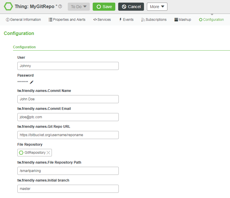

First, configure your Git repo to work with ThingWorx by creating a Git Backup Thing. Then, simply open your new Thing, navigate to the Configuration editor and enter information like your Git URL, your Git username and password, your repo and branch names, etc. See example below.
imageConfiguring your Git repoWith this configuration in place, you can now use the Home Mashup of this new Git thing to browse the repository and pull down contents to your local ThingWorx instance. For new projects, you can also push new entities to the repo as you work on your application.

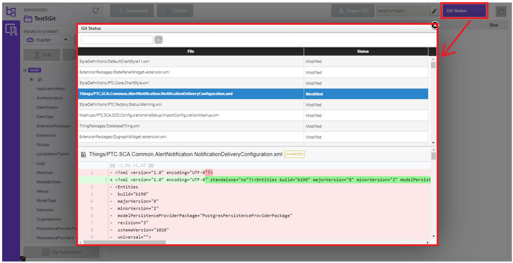

As you and your team are working, you’ll want to see the differences of the files you are editing and working on collaboratively. The Git extension feature makes this easy. Just like you can see diffs clearly delineated for a file with your Git client, you can see the same with this Git integration in ThingWorx. Similar to the git status command, the Git ThingWorx extension will show you the list of files you have changed that are available to push, as well as their diffs. See an example below.
imageChecking the Git status

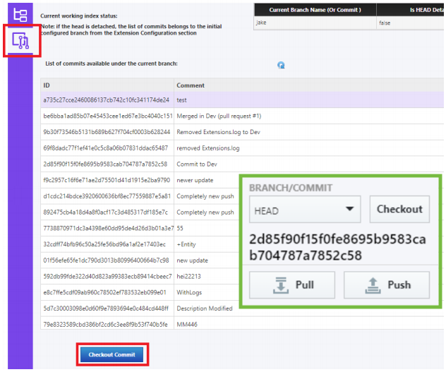

While working, if you want to switch branches or pull down a new project, you can check out a specific version and see all commits available on that branch (see below).
imageChecking out a specific commit

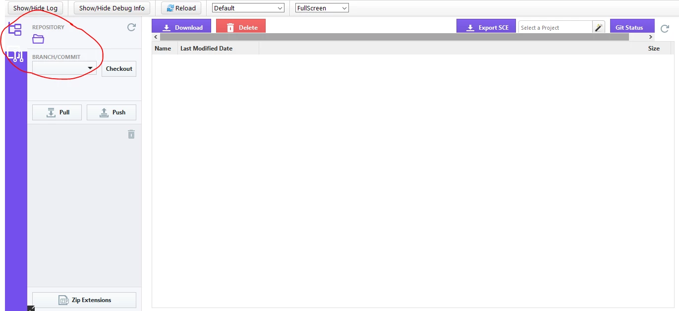

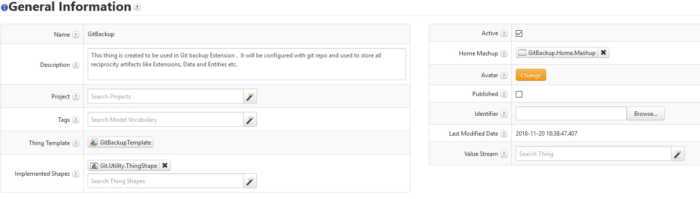

Nov 21, 2018 12:32 AM UTC
I have installed this extension and configured.
I am not able to see any repository on mashup page .
I am able to use all git commands from repository created into storage, but only tis it is not getting displayed in mashup. Find attached screen shot for reference.
Let me know if anyone has faced this issue.
Thanks in advance,
Vishwas

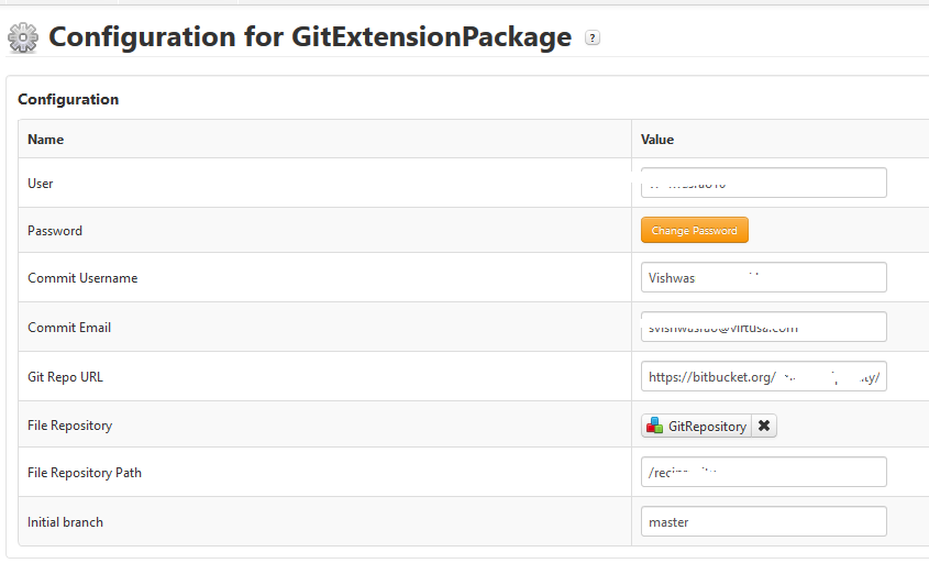

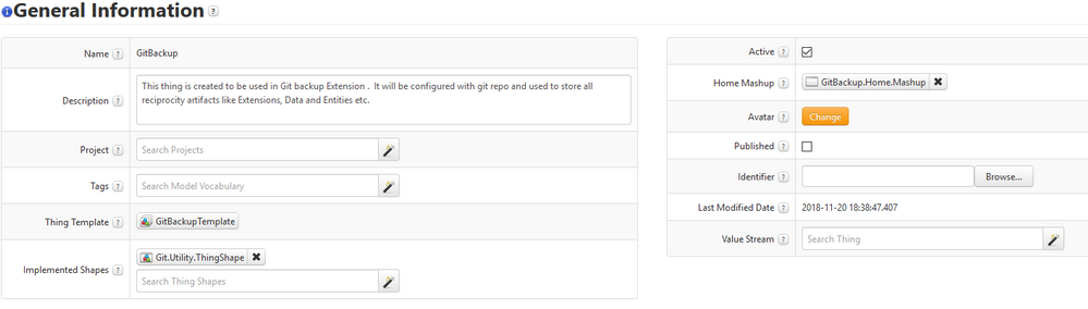

Nov 21, 2018 2:13 PM UTC
Vishwas, can you share the values from the Configuration page from that Git thing that was created?
Also, can you share if the Thing has a ThingShape attached in the General Information page?
Nov 21, 2018 4:38 PM UTC
imageGitbackup ThingimageHi,
Please find attached screen shots for same.
