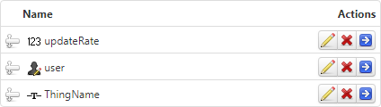

  • The following service, which can be created on any Thing, will create a new Timer using the following Inputs:

var params = {
	name: ThingName /* STRING */,
	description: undefined /* STRING */,
	thingTemplateName: "Timer" /* THINGTEMPLATENAME */,
	tags: undefined /* TAGS */
Resources["EntityServices"].CreateThing(params);
// read initial configuration
// result: INFOTABLE
var configtable = Things[ThingName].GetConfigurationTable({tableName: "Settings"});
// update configuration with service parameters
configtable.updateRate = updateRate
configtable.runAsUser = user
// set new configuration table
var params = {
	configurationTable: configtable /* INFOTABLE */,
	persistent: true /* BOOLEAN */,
	tableName: "Settings" /* STRING */
Things[ThingName].SetConfigurationTable(params);
