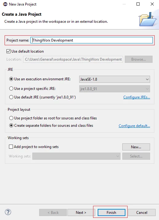

Create Java Project

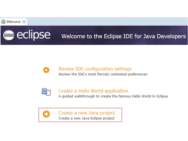

  1. When the Eclipse Welcome window appears, click Create a new Java Project.
  2. In the New Java Project setup wizard, enter ThingWorx Development as the project name. Java 1.8 is the supported and recommended JDK.
  3. Click Finish.

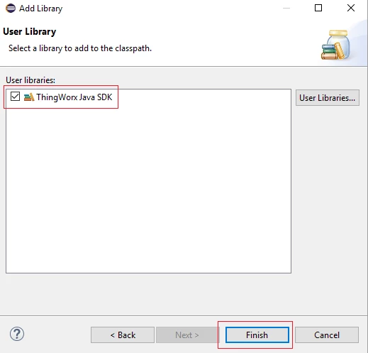

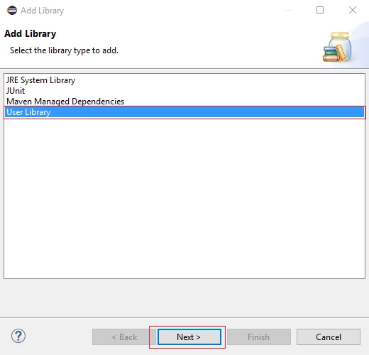

Set Up User Library

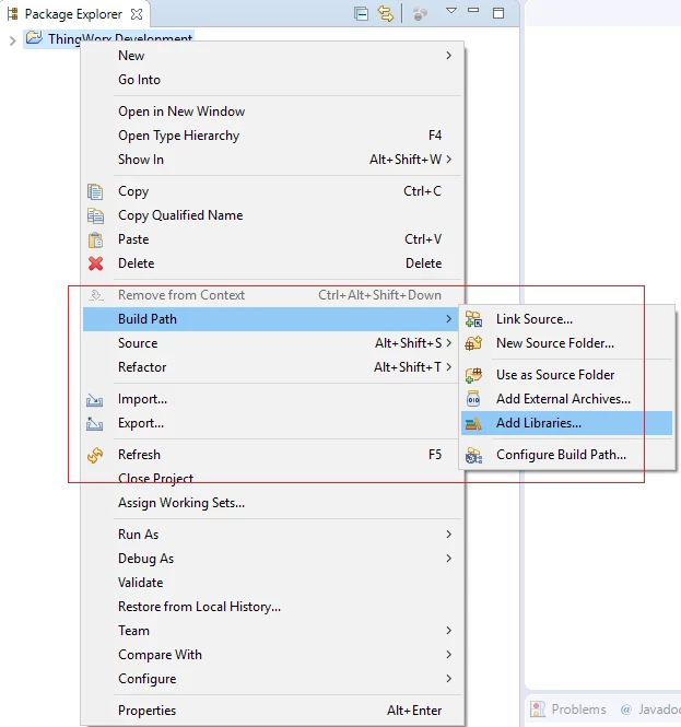

  1. Right click the newly created ThingWorx Development project in the Package Explorer.
  2. Expand the Build Path selection and select Add Libraries.

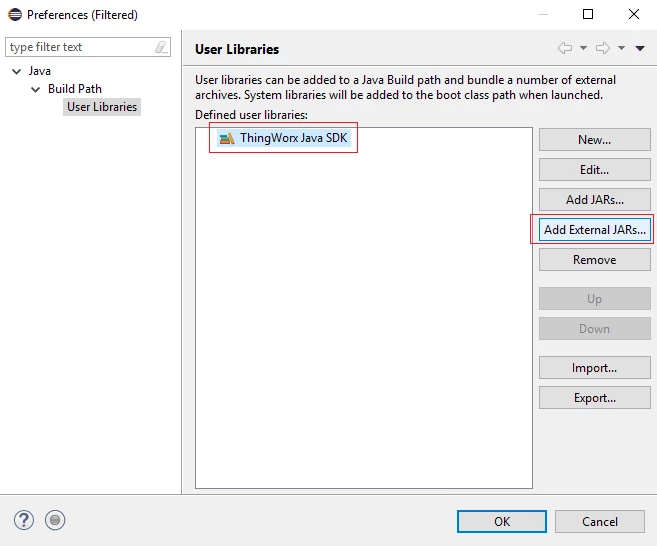

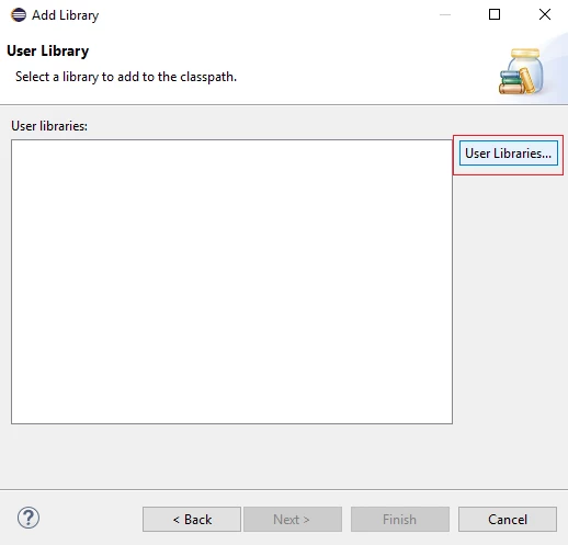

  3.  Click User Library. Click Next.

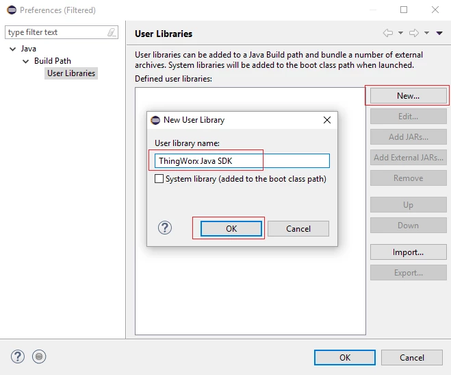

  4.  Click User Libraries.
  5. Click New, enter ThingWorx Java SDK as the library name. Click OK.

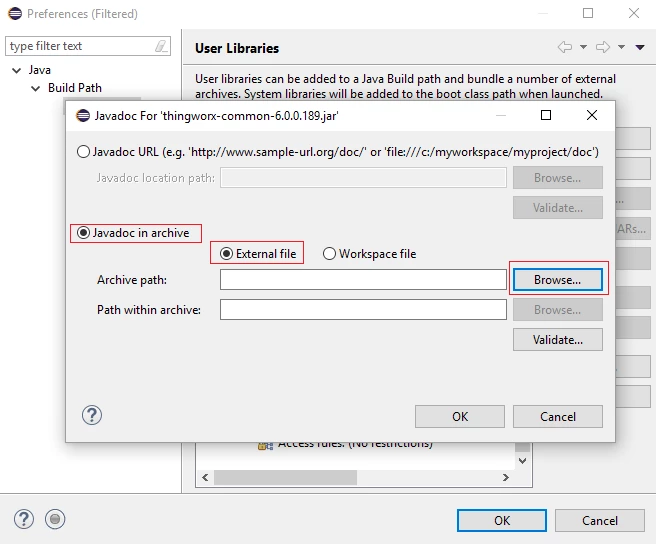

Set Up Javadoc

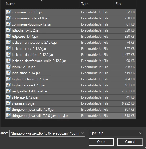

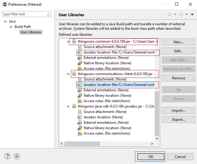

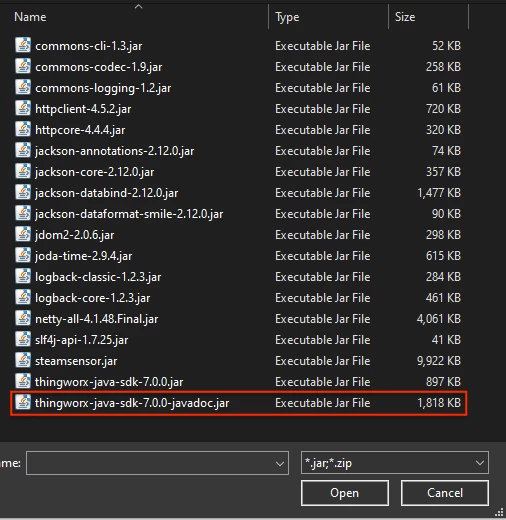

  1. With the ThingWorx Java SDK selected, click the Add External JARs button.
  2. In the pop-up window, navigate to the location in which you unzipped the ThingWorx Java Edge SDK.
  3. Navigate to the lib folder, select all of the JARs, then click Open.

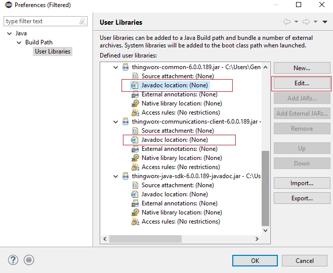

  4. Within the ThingWorx Java SDK library, expand the thingworx-common-xxxx.jar folder and select Javadoc location.
  5. Click Edit.
  6. Select the Javadoc in archive and External file radio buttons, then click Browse.
  7. In the pop-up window, navigate to the location in which you unzipped the ThingWorx Java Edge SDK. Navigate to the lib folder, highlight the thingworx-java-sdk JavaDoc JAR File, then click Open.
  8. Click OK.
  9. Repeat steps 1-8 for the thingworx-communications-client JAR’s Javadoc location field shown in step 10.
  10. Confirm that your setup looks like this:

  12. Select the checkbox for the ThingWorx Java SDK library, then click Finish.

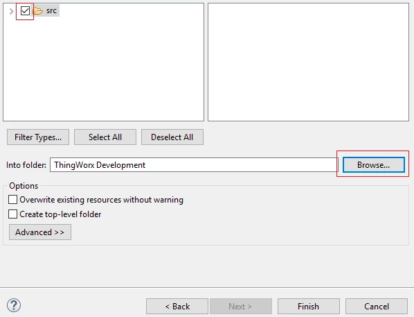

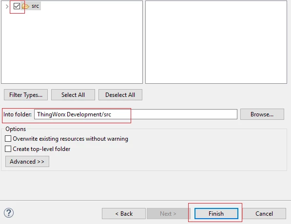

Import Sample Files

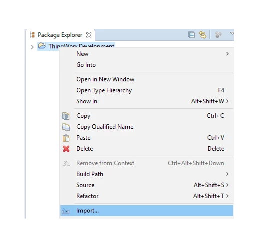

  1. Right click the ThingWorx Development project and click Import.Step-Java-14.png

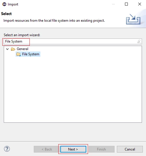

  2. In the Import wizard, type File System into the filter. Click Next.

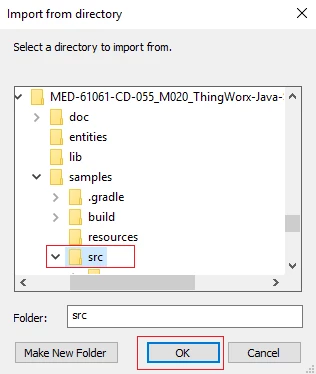

  3. In the pop-up window, navigate to the location in which you unzipped the ThingWorx Java Edge SDK. Navigate inside the samples folder and select the src folder.
  4. Click OK.

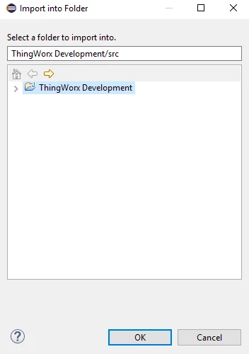

  5. Select the checkbox for the src folder, then click Browse.
  6. Type ThingWorx Development/src into the text box.
  7. Click OK.
  8. Click Finish.
