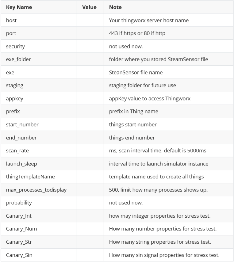

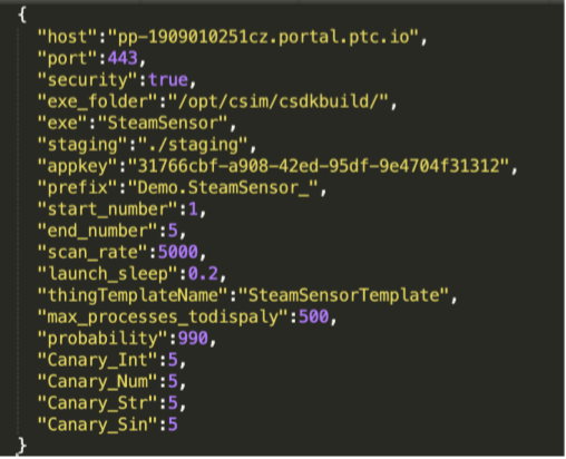

  6. Update the configuration file for the simulator
    1. Open /opt/csim/simulator.json  (or whatever path is used instead)
    2. Edit this file to meet your environment needs, based on the information below

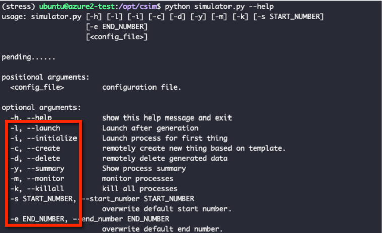

  7. Familiarize yourself with the simulator.py file and its options
    Use the following command to get option information:
    python simulator.py --help​

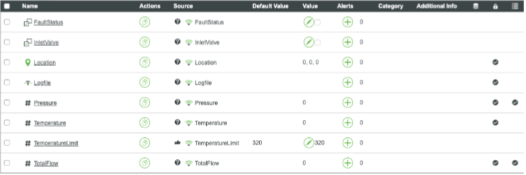

    Each simulator instance will have 8 remote properties by default (as shown in the picture in the Background section). More properties can be added for stress test purposes in the simulator.json  file.
    For the simulator to run 1k writes per second to a time series database, use the following configuration information (note that for this test, a machine with 4 cores and 16G of memory was used. Greater hardware specifications may be required for a larger test):
    1. Forget about the default 8 properties, which have random update patterns and result in difficult results to check later. Instead, create "canary properties" for each thing (where canary refers to the nature of a thing to notify others of danger, in the same way canaries were used in mine shafts)

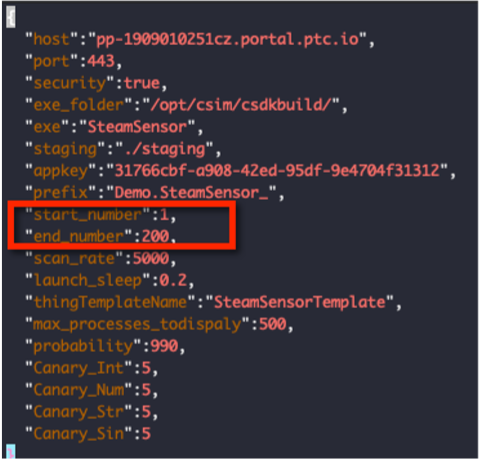

    4. The simulator.json  file should look like this:
      Canary_Int: 10
      Canary_Num: 5
      Canary_Str: 5
      Canary_Sin: 5
      Start_Number: 1
      End_Number: 200​

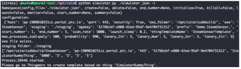

    1. Enter the /opt/csim  folder, and execute the following command:
      python simulator.py ./simulator.json -i​
    2. You should be able to see a screen like this:

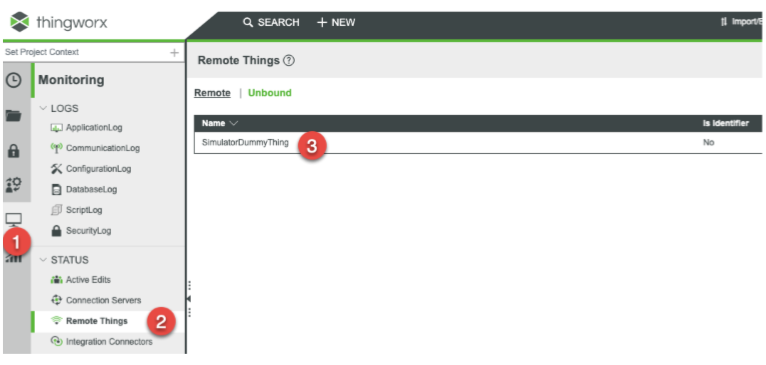

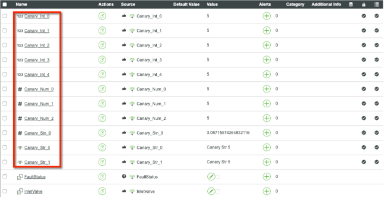

    3. Go to ThingWorx to check if there is a dummy thing (under Remote Things in the Monitoring section):
      This indicates that the simulator is running correctly and connected to ThingWorx

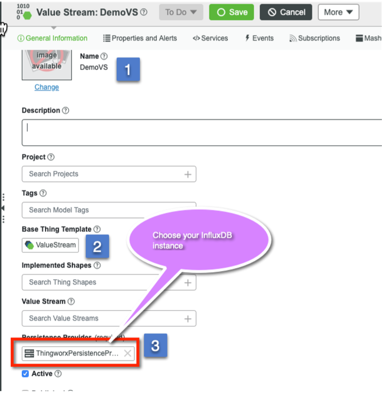

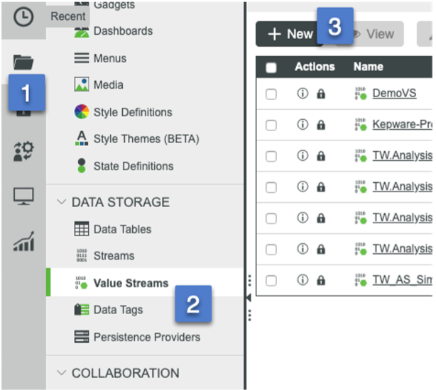

  3. Create a Value Stream and point it at the target database

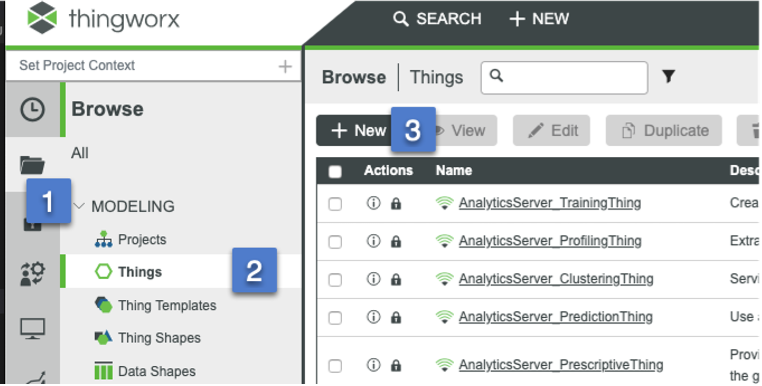

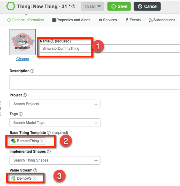

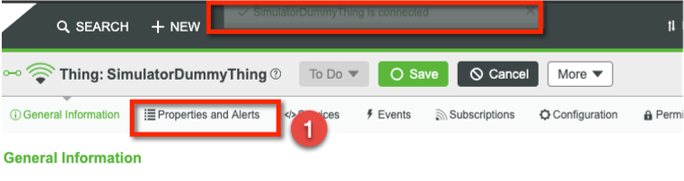

  4. Create a new thing and call it "SimulatorDummyThing"
    Once this is created successfully and saved, a message should pop up to say that the device was successfully connected

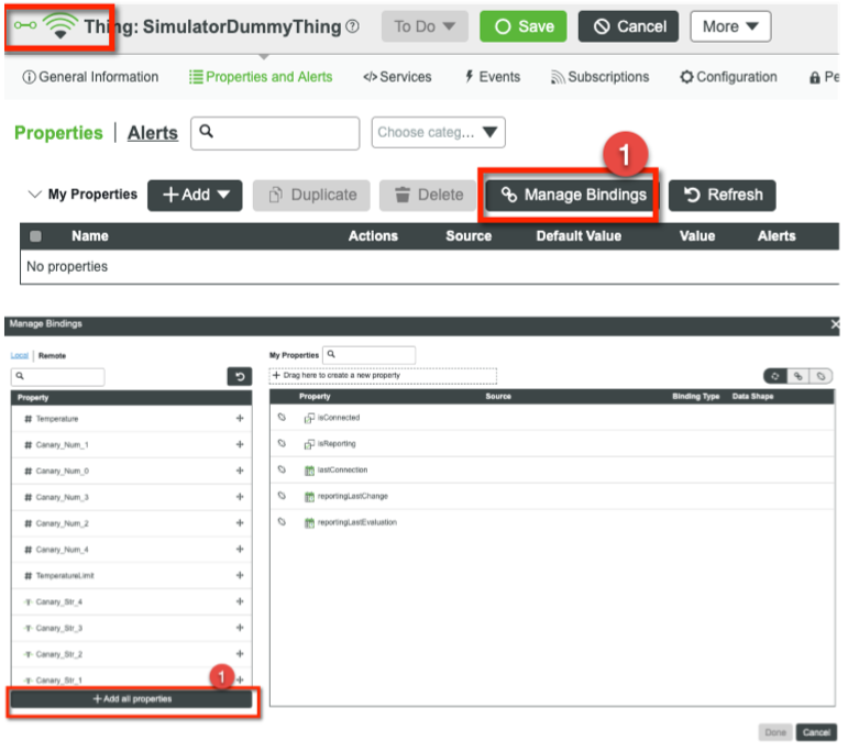

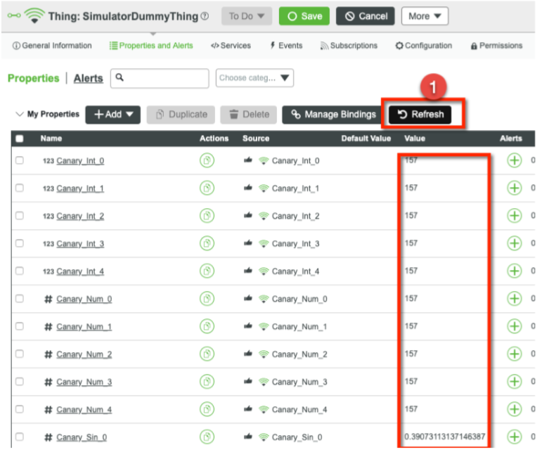

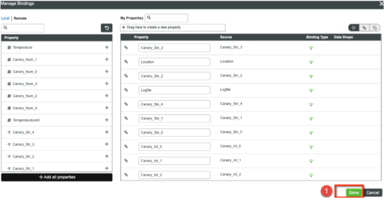

  5. Bind the remote properties to the new thing
    1. Click the "Properties and Alerts" tab
    2. Click "Manage Bindings"
    3. Click "Add all properties"
    4. Click "Done" and then "Save"
    5. The properties should begin updating immediately (every 5 seconds), so click "Refresh" to check

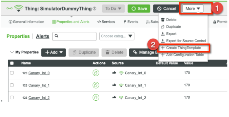

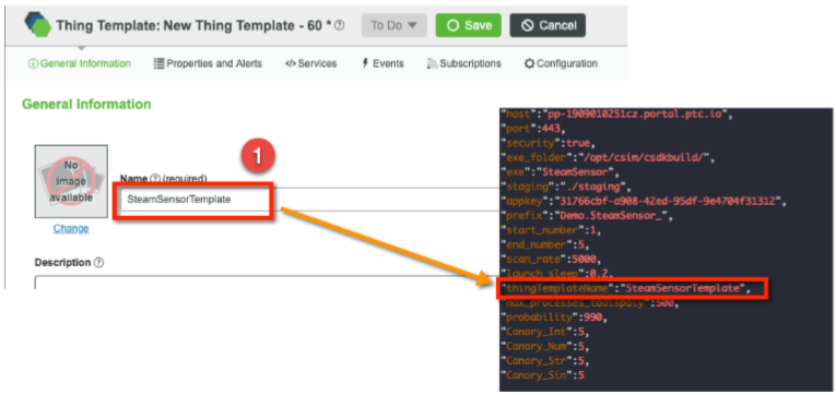

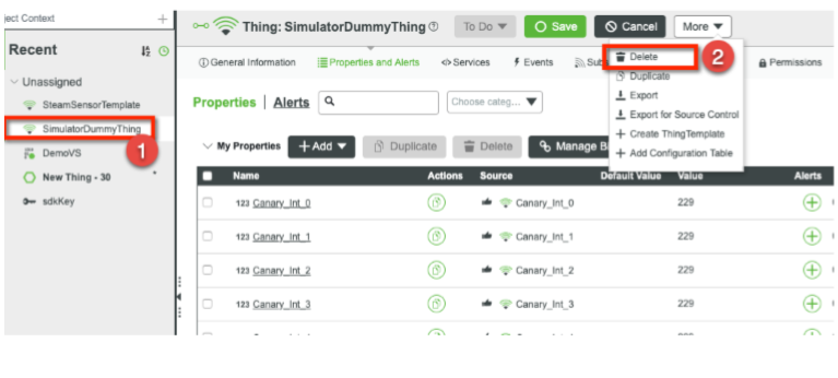

  6. Create a Thing Template from this thing
    1. Click the "More" drop-down and select "Create ThingTemplate"
    2. Give the template a name (ensure it matches what is defined in the simulator.json  file) and save it
    3. Go back and delete the dummy thing created in Step 4, as now we no longer need it

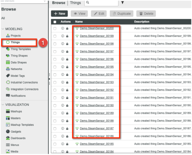

  8. Create 200 things in ThingWorx for the stress test
    1. Verify the information in the simulator.json  file (especially the start and end numbers) is correct

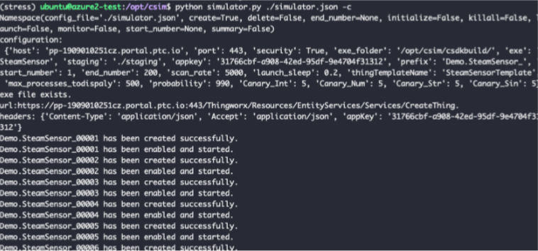

    2. Use the following command to create all things:
      python simulator.py ./simulator.json -c​
    3. The output will look like this:
    4. Verify the things have also been created in ThingWorx:

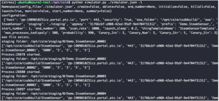

  1. Use the following command to start your test:
    python simulator.py ./simulator.json -l​
    or
    python simulator.py ./simulator.json --launch
  2. The output in the simulator will look like this:

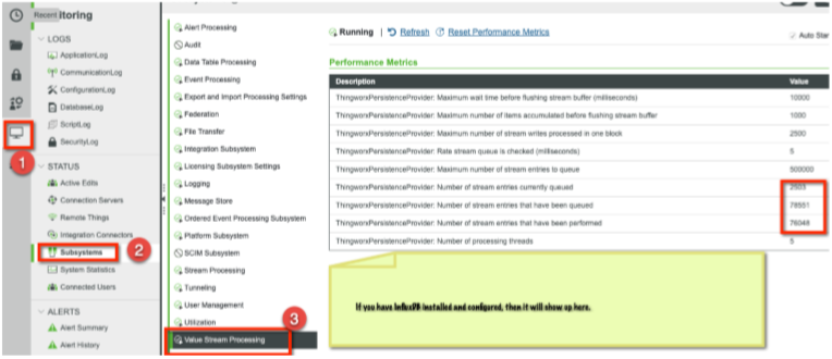

  3. Monitor the Value Stream writing status in the Monitoring section of ThingWorx:
