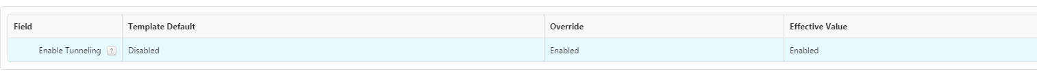

      1. In the newly created Thing, on the General Information page, click on the drop-down menu next to Enable Tunneling and select Override - EnabledenableTunneling.PNG

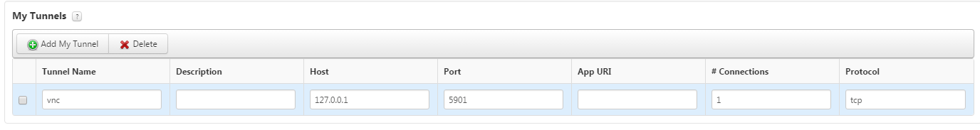

      2. ​Go to the Configuration​ section under ​Entity Information ​on the right and click on the Add My Tunnel ​buttontunnelMyTunnels.PNG
        • The Tunnel Name is used to identify what tunnel to use in the RemoteAccessWidget you will bind to the tunnel
        • The Host will remain 127.0.0.1 because this is from the perspective of where the vnc server is to the remote device
          • In my example they are on the same device
        • The Port value should be the Port that the server is listening on
          • This is typically 5900, but my vnc server is running on port 5901 for this example

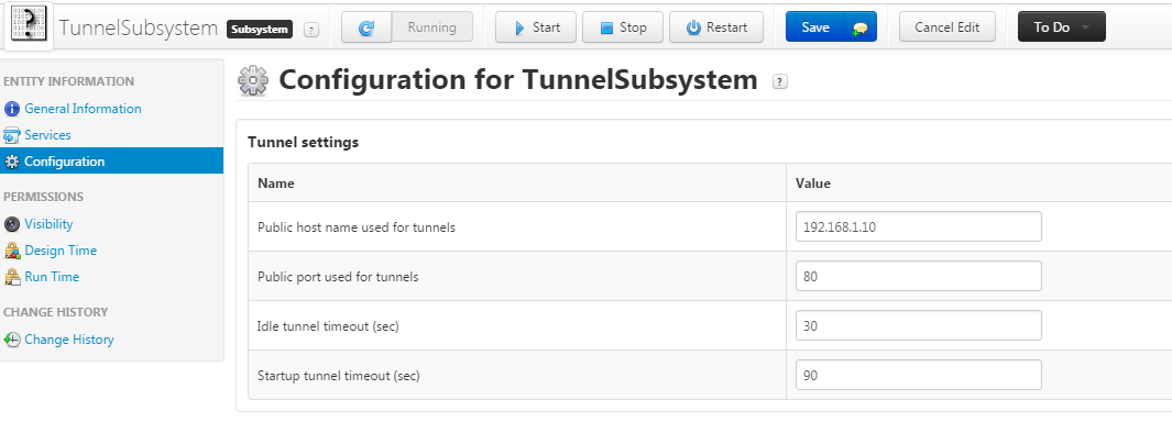

    3. Navigate back to Home and look for the TunnelSubsystem under the Subsystems page
      1. Click on the TunnelSubsystem
      2. Click on the Configuration option on the left
      3. Modify the Public host name used for tunnels field and the Public port used for tunnels field to the host and port of your ThingWorx servertunnelSubsystem.PNG
      4. Save and close the TunnelSubsystem

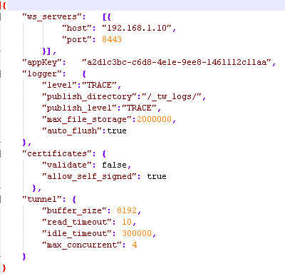

  2. Configure the config.json file settings to match the server's host, port, and application key
    • The ​tunnel​ block will be necessary to add as well, see below for an example of a working config.json file:config.jsonTunnelingEMS.PNG

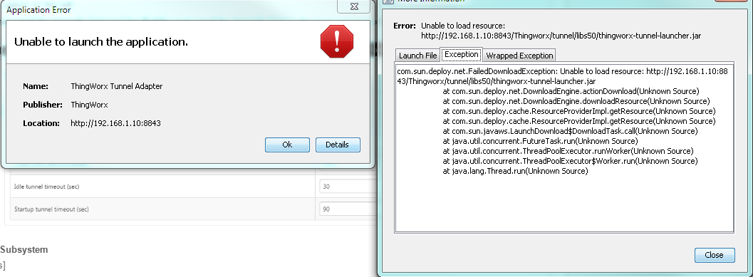

    • Keep in mind that there is a default 90 second timeout defined in the TunnelSubsystem that will render the wsadapter.jnlp file useless and you will have to download a new one if the connection is not established within that timeframe
    • If you receive the following error message you may need to reconfigure your TunnelSubsystem configuration options for your server because the thingworx-tunnel-launcher.jar was unable to be found at that address

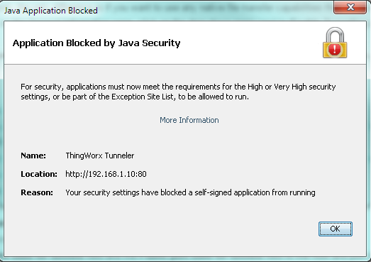

    • If you receive the following error message after you will need to modify your security settings in your Java options. This is done by opening ​Configure Java​, navigating to the ​Security ​tab, and then adding your ThingWorx server's IP and port to the site list via the ​Edit Site List...​ buttontunnelJavaApplicationBlockedError.PNG

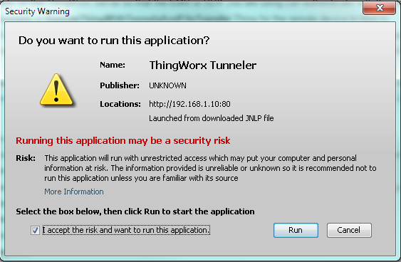

  4. You should have received a Security Warning message upon successfully finding the thingworx-tunnel-launcher.jar file that you will click the ​Run​ button on and check the I accept the risk and want to run this application​

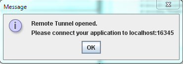

  5. A pop-up, like the following, will be seen and you know the tunnel is now open for tightvnc to connect through
    • Do not click ​OK​, instead, please proceed to the next step. Clicking OK will close the tunnel if you have not connected to the EMS via the VNC Viewer yet.

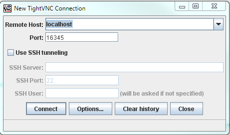

  6. Open the tightvnc-jviewer.jar and type in the corresponding host and port that a vnc connection should be established to: tightvnc-jviewerSetup.PNG
    • localhost ​ and port ​16345​ are used because we have already established a connection to the EMS and it is listening for a vnc connection on port 16345 -- per the ThingWorx pop-up we just saw

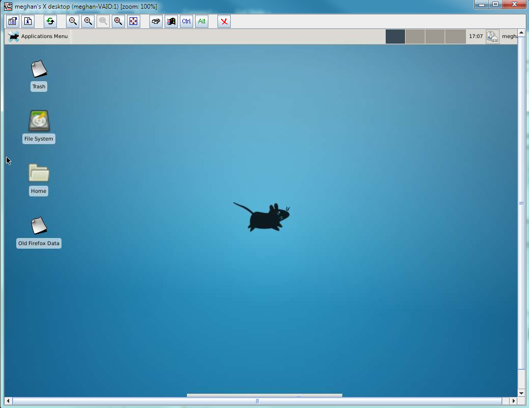

  7. Click ​Connect​ and a new window should appear showing the GUI environment of your Ubuntu server like belowtunnelxInterfaceSuccess.PNG

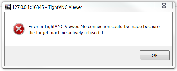

I am having an issue with the final step (and I think I did everything right up until now). I see this error message when I try to connect to the server:
or this one when I use 127.0.0.1::16345 instead of localhost::16345:
I installed TightVNC on Windows just for local testing purposes, so hopefully that is not the issue (it should work this way, shouldn't it?)
Let me know your thoughts. Thanks!

You are connecting from your local machine I'm assuming, Windows, and what are you connecting to? Whatever you are connecting to needs the TightVNC Server installed on it, and then your local machine has the TightVNC Viewer installed on it.
Meghan
Jul 27, 2016 4:58 PM UTC
Right, I am all on one host, and wondering if that is a problem. I am connecting to the EMS which is also running on localhost. TightVNC is running on localhost, also (like I can start and stop it in the Services windows application). Oh, wait do I need to connect the EMS to the VNC server in some way? I am a little confused about how this works conceptually, I suppose
Jul 27, 2016 6:01 PM UTC
You are definitely going to need at least two separate devices (one to host the EMS and one to host ThingWorx).
To explain this a bit further, in a more real world example, you will have a ThingWorx server sitting somewhere on a machine, an EMS out in the field on another device, and then your client machine (laptop). The client machine is where tightVNC Viewer is installed and the EMS device is where the tightVNC server is hosted. Traffic is routed from client machine to the ThingWorx server then to the EMS device and back again, so trying to open a tunnel from a client machine that is hosting an EMS and the ThingWorx server is not an appropriate testing scenario because you are not tunneling outside of your localhost. This is why you are seeing the connection refused.
Jul 27, 2016 6:05 PM UTC
Ah, ok. I suspected as much. Now I just need to remember who borrowed my Raspberry Pi... thanks for your help clarifying this!

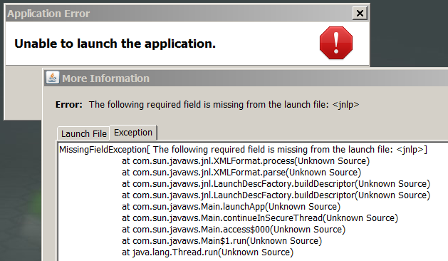

I am having an issue at Establishing a Tunnel.  When I click on wsadapter.jnlp I do get the error "Unable to launch the application", but is a different error then you describe.
I have been unable to find a resolution.  Do you have any ideas on what the issue could be?  I am using ThingWorx version 7.1.2-b6 on Windows 7.

Sep 28, 2017 9:32 PM UTC
This error often appears when the remote device isn't actually connected to the Platform.

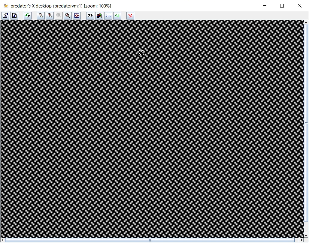

I followed the document and after too many hiccups, I am able to establish the tunnel. However at step #7 instead of getting remote desktop GUI, I am getting blank/black screen. See below.
I have TWX on Windows machine, EMS and Ubuntu and VNC Viewer on on another Windows machine.
I would really appreciate if you can you please help me get this working the last piece of problem.
