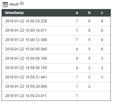

  • Create a new Thing with some NUMBER properties, e.g. 'a', 'b' and 'c' as properties - ensure they are marked as logged as well
    • Name = InfluxValueStreamThing
  • Create a new ValueStream based and change its Persistance Provider to the InfluxDB created above
  • Save both Entities
  • Setting values for the properties will now automatically create the entries in InfluxDB - including the Entity name "InfluxValueStreamThing"
  • Running the QueryPropertyHistory service on the Thing will return the results as an InfoTable

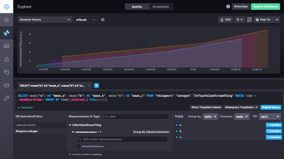

  • In Chronograf this will display like this:
