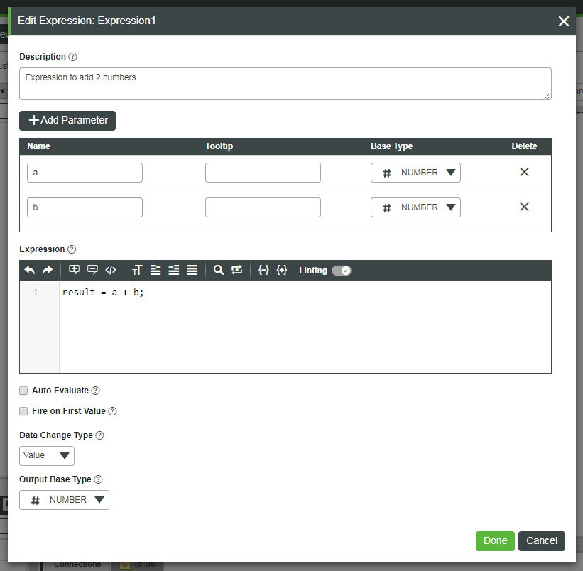

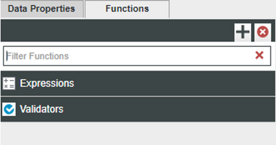

You’ll see a new tab called “Functions,” which, on default, appears in the bottom right panel.image
Click the “+” arrow in the top right of the “Functions” panel. Choose “expression.”

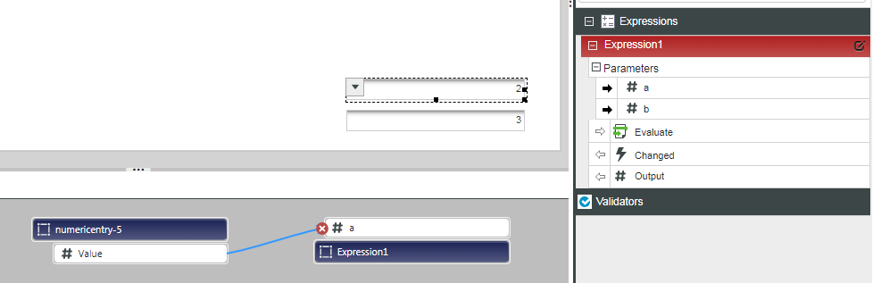

Use the new Functions editor to write your expression. In this example, we’ll say that result = a + b;imageNew Functions Editor
 We’ll then set the default values for a and b to be 2 and 3, respectively, to output a result of 5.
Expressions are just as powerful as they were before, but they no longer take up space on your mashup during design time, and they can now be configured in our brand new editor! (To spread the joy even more, the same holds true for validator widgets.)
