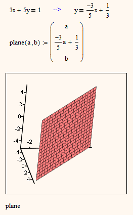

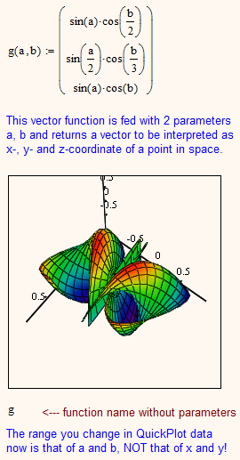

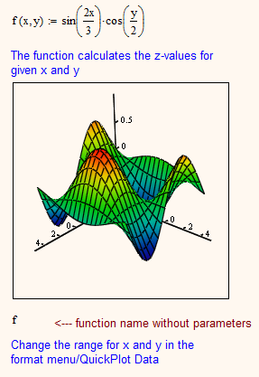

Mathcad has a nice feature: You define a function in the two parameters x and y which returns the z-value of a point and if you provide Mathcads 3D-graph with only the function name it will (quick)plot the surface. By default x and y a running from -5 to 5 in 20 steps, but you can change this in the format menu. You Can add more functions by typing a "," after the first function name and then the next name.
Valery and myself have chosen that feature to plot our planes. We let the symbolic processor solve the equation for z, assign the result to a function (z0(x,y) e.g.) and put that name (z0) in the placeholder of the 3Dplot.
Unfortunately this method will not work for one of your two planes (3x+5y=1). Obviously we cannot solve that equation for z as z is missing. This means the plane is vertical, perpendicular to the xy-plane or in other words, its parallel to the z-axis. We have a similar problem now as in a 2D-plot when we want to plot a vertical line - it doesnt work the way it works for any other nonvertical straight line.
But mathcad provides different ways to plot 3D-graphs and one is using the parameter form of the surface. A good example was given to you by Stuart when you asked how to plot spheres two months ago (http://communities.ptc.com/message/195210#195210). We can define a function with two parameters (I will call them a and b for typing simplicity) which returns a 3-dimensional vector, representing the x,y,z-coordinates of a point in 3D. Again you feed Mathcads 3D-graph with the function name and it will plot it for you. This time you do not have that much control over the x- and y-range, as the appropriate setting in the Format menu would apply to the parameters a and b!
This was the method I used to plot your vertical plane. I chose a to be the x-coordinate, y is calculated according to the equation you provided and z was set to parameter b, being any arbitrary value.

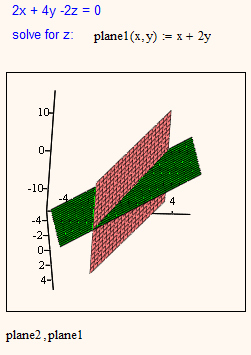

Of course you can mix those ways of plotting a surface and that way I plotted your two planes - each one in another way:

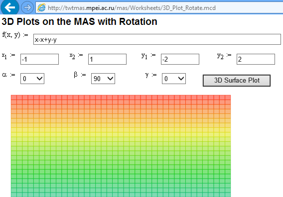

March 28, 2013
A vertical Plane
March 28, 2013
Valery Ochkov wrote:
A vertical Plane
Sorry, but thats a horizontal plane (z=0). So we see, its all a matter of the point of view.
BTW, I think that online sheet of yours would be enhanced greatly if axes where included in the plot. And I don't speak of those silly and often confusing scales Mathcad includes in 3D-plots but the real axes which intersect in (0,0,0).

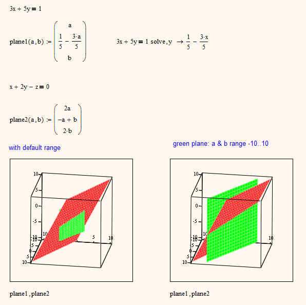

OK, as you like the parametric approach - lets go. You made both planes perpendicular to the xy-plane, which at least the second one is not. I don't understand how you would arrive at the parametric representation you have shown. Following is the way I would do.
First plane: 3x+5y=1.
Our goal is a 3x1 vector with a parametric representation, which would of course mean we have to use two parameters (lets say a and b) to calculate the three vector elements. A parametric representation is not unique, there is an infinite number of them to chose from, so we will chose the most convenient one.
The equation for our plane does not include z, so its convenient to set z=b and then we will find a way to express x and y using parameter a alone. Its convenient to set x=a and if we solve our euqation for y we get y=-3/5x+1/5 which means y=-3/5a+1/5.
So one possible representation is
[ a ]
[ -3/5a+1/5 ] no idea how you arrive at -2a+b here
[ b ]
another one would be
[ -5/3*a+1/3 ]
[ a ]
[ b ]
and there are many more, all would represent the same plane. What part of the infinite plane you see in the Mathcad plot and how fine the grid is would depend upon the range of a and b which you can set in the diagram format menu (Quickplot data, Range1 & Range2, default is -5..5, grid:20).
Second plane: x+2y-z=0 (already simplified by dividing by 2)
One possible way is to set x=a, y=b and then calculate z=x+2y, that is z=a+2b
So we have
[ a ]
[ b ]
[ a+2b ]
other possibilities are
[ a ] [ 2a ]
[ -a/2+b/2 ] or [ -a+b ] no idea how you arrive at -2a+1 here
[ b ] [ 2b ]
or
[ -2a+b ]
[ a ]
[ b ]
