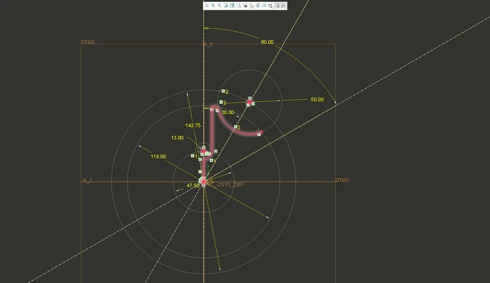

Hello PTC community. I am asking for assistance in making an extruded figure for a geneva cam.

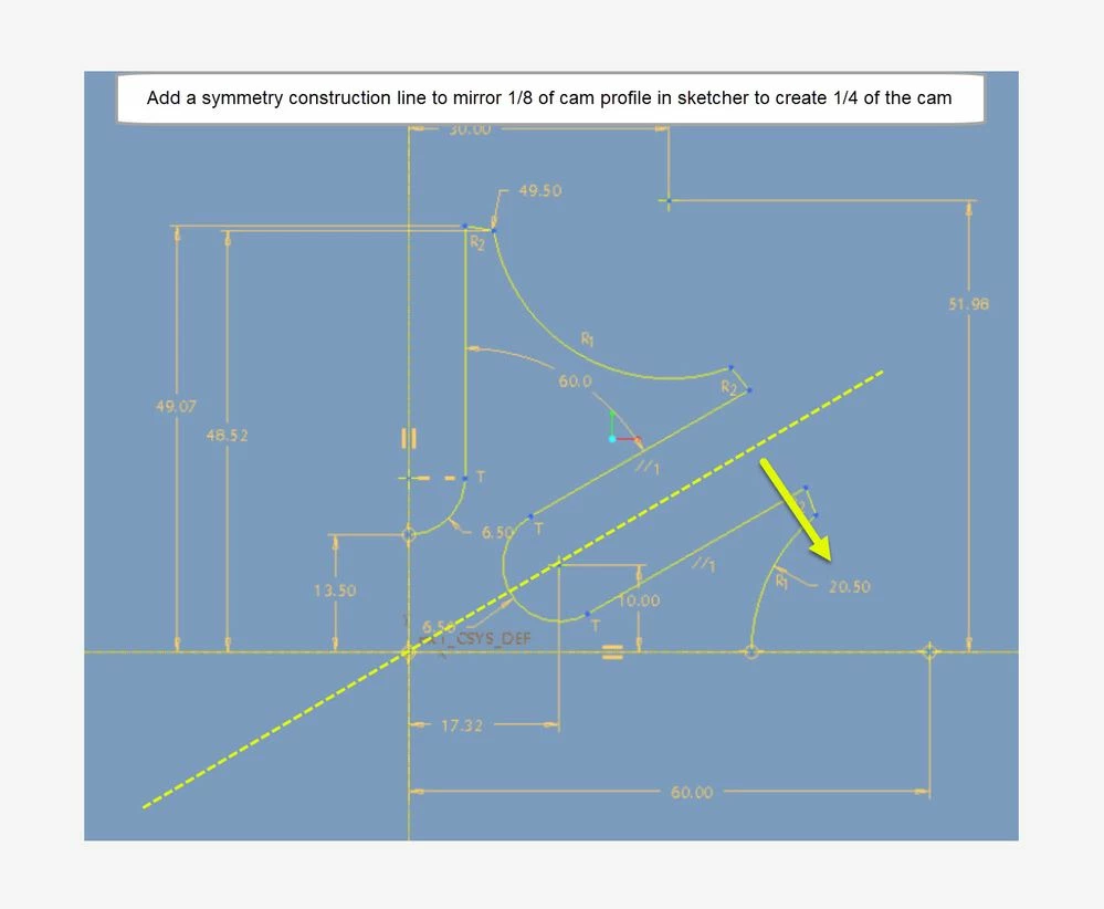

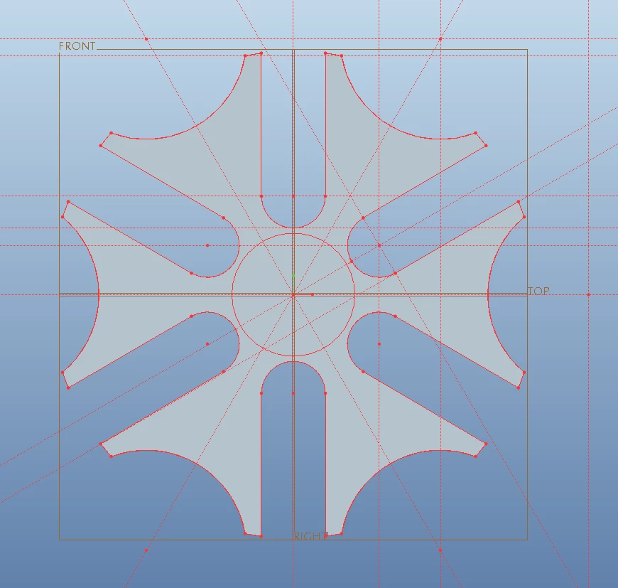

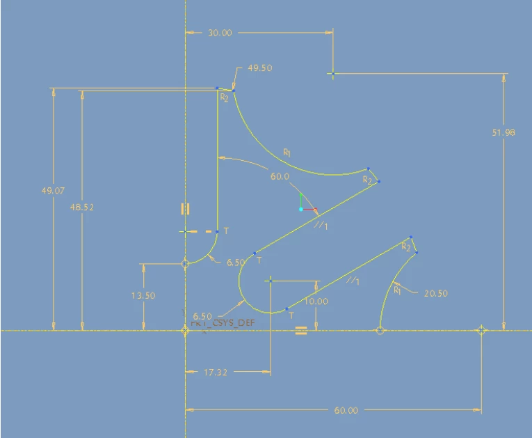

I spent a while figuring out dimensions since instructions were not clear to me and now I am struggling with extruding my sketch. I have attached the instruction's reference image as well as my creo part. The error I am getting is that there is overlapping geometry and my sketch is not looking symmetrical.
Note: the center for the three arcs (of Radius R2) is at the origin.
Could someone please fix my mistake and point out a simple way of fixing the geometry?
Much appreciated, thank you.
