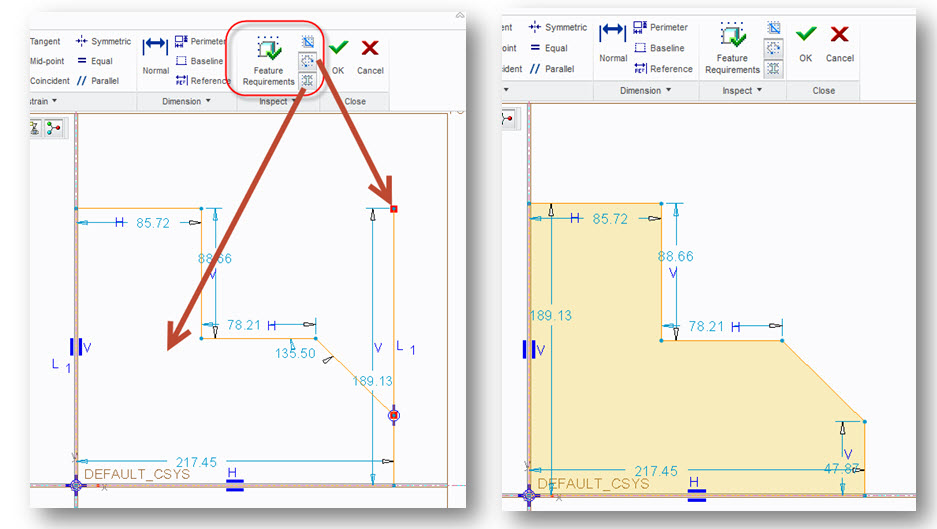

Being fairly new at PTC/Creo, I often find myself in the middle of a complex 2d sketch and then when I try to save it gives an error like. Too many open loops.
I search over the sketch, re-examine dimensions, check lines... intersections... and eventually find a stray line bit or something not quite square.
The question is. Does anyone have any tricks, or perhaps there is a way in the software, to analyze the sketch and bring out these errors quickly. The amount of time wasted, searching or redrawing is pretty frustrating.
Thanks for any tips out there.
I'm attaching a file of a current problem I'm having. I can't find the problem.

    Hi Brett,
    1. Reduce the number of features in your sketch.
    You have a basic shape of a half disc, start with that
    The other circular cutouts can be patterned
    The slots can be patterned
    Center hole may be a single feature
    2. Use construction axes to help constrain features

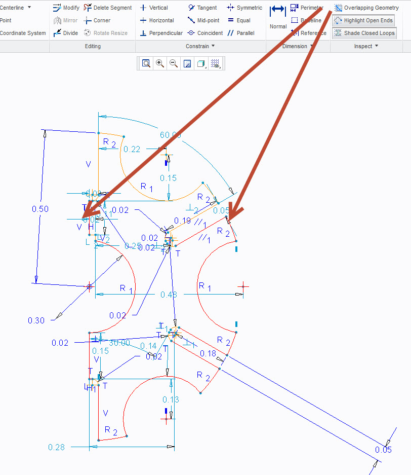

    3. Use the inspection dialog (second picture)
    Overlapping geometry highlighted below.

    Jun 27, 2013 5:52 PM UTC
    Josh is correct, the first rule of thumb (especially for new users) is to make more features and simpler sketches. I would rather have a new user create a part using 5 simple sketches and extrusions rather than a very complicated sketch. As you get experience, you will find your sweet spot with this.
    In your example, the Overlapping Geometry tool highlighted many entities in red. They way I use the tool is to look for 3 entity chains that are highlighted, then delete the middle red entity. If you have an overlapping entitiy (one on top of another) you will see the entity below after deleting. If not, click Undo. Not perfect but the method I teach. In your section, the other arc had many arcs on top of one another. Removing them made the section closed.
