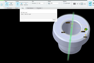

For sake of completeness, I'm noting that at some point since 2015 (it is there in Creo 10), standardized notes can specified and automatically attached to the "simple" type of holes:
To be fair, the out-of-the-box hole format remains somewhat awful looking, but it can be customized to fit your standards.
Yes but it doesn't support counterbore or countersink holes. I'm also wondering if we can customize the number of digits.
Yes, out of the box it doesn't, but you can customize the DEFAULT_CALLOUT_FORMAT_DATA table in the hole files simple_drilled.hol and simple_flat.hol

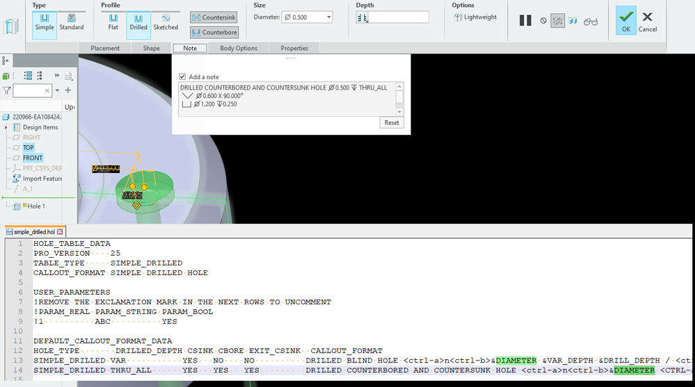

For illustration:
The number of digits can be controlled by the "standard" method of appending the [.n] to the &parameter callout where n is the # of decimal places.  For example above, if my callout definition was &DIAMETER[.1] then note would show Ø0.5 instead of Ø0.500

The system .hol files are in the folder
...\Creo 10.0.5.0\Common Files\text\hole
The config.pro option
hole_parameter_file_path lets you define your own location for the .hol files
Note this is documented in the on-line help.

Hi, thanks for the tip. I had already tried to customise these hole notes but it wasn't working. I just reviewed my files and notice I had an exclamation mark at the beginning of each line (don't know why) making them comments only ! 😏
