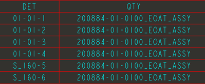

I want to add portion of main assembly name into repeat region for each member:
FIXTURE=extract(asm_name,8,5)
DETAIL=FIXTURE + '-' + itos(rpt_index)
For parts it works as expected: 01-01-1, 01-01-2, etc
The problem is that "asm_name" in repeat region relations returns value for sub-assembly name which exists in main assembly: S_160-5, S_160-6.
If I place "asm.name" under QTY column everything is as expected.
DET column gets values from relation: rpt.rel.DETAIL
What am I doing wrong?

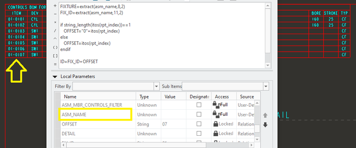

Another way to accomplish this would be to add asm_name to the list of local parameters within the repeat region. It's a better way to calculate the value without having to deal with shown/hidden columns. When calculating values for BOM attributes within a repeat region, the relations need access to the thing they're trying to calculate.
  1. Edit the relations of your repeat region
  2. Expand the list of local parameters
  3. Click the plus icon to add a new parameter to the repeat region

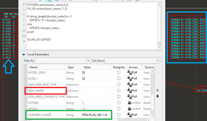

I have weird issue here. Parameter ASSEMBLY_NAME showed up (I did not place it there) and it is for gripper assembly (in this case) and last column in BOM shows my main assembly name (cyan square on the left).
You can see that last row is getting info from ASSEMBLY_NAME parameter instead of asm_name in my relation. All others are ok.
Then I made new table from zero and I added asm.name in column and then removed it. So, now relation works as expected.

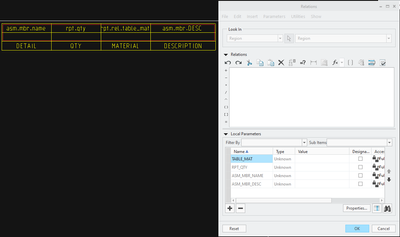

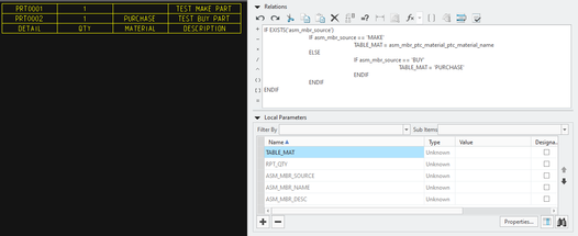

At this point, I typically replace the parameter in the Material column (PTC_MATERIAL_NAME) with one I can manipulate (TABLE_MAT). Here is the new table and screenshot of the relations. Notice that the parameters being displayed in columns are added to the list of local parameters in the repeat region.
According to my requirements, I need to compute the value in the Material column based on whether or not I’m going to manufacture the component or buy it. A likely candidate for this would the Source parameter. My customer doesn’t want Source in the BOM so I need to get a little creative. This is where I would need to add source to the list of local parameters in the repeat region. It’s not a column so it doesn’t appear by default. I need to add it myself so that I can use it in my code. See the steps in my previous response. Here’s a new picture:

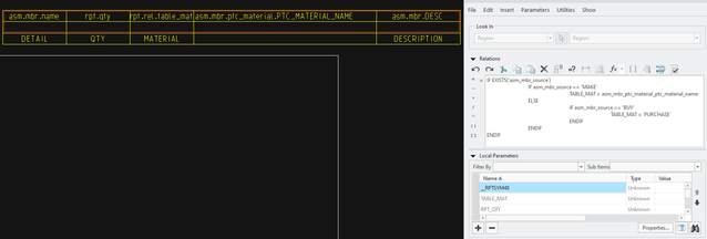

Now, I can add the code that computes the value of TABLE_MAT based on the value of SOURCE. Notice that the Material column is populated properly for my buy part but the make part is blank. This is because my make part calculation is calling ASM_MBR_PTC_MATERIAL_PTC_MATERIAL_NAME but the relations don’t have access to that attribute. It’s not a column, so I need to add it to the list of local parameters. This is where things get a little weird…
Notes:
  • This is quick prototype code that isn’t handling some exceptions.
  • I would normally use a user defined parameter here to get around the upcoming behavior.

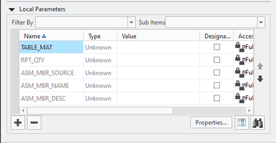

A little earlier I mentioned that if an attribute is needed for relations and isn’t shown in a column, it needs to be added to the local parameters. The way that you would “convert” a parameter from the repeat region to the relations is to replace the “.” With “_”. A column reporting PTC_MATERIAL_NAME would look like this: asm.mbr.ptc.material.ptc.material.name. If we convert for use in relations, you get this: asm_mbr_ptc_material_ptc_material_name. If you try adding that to the local parameters, you’ll violate the character limit. What?!
Another way to add the attribute to the parameters is to add the column back. Adding a column also adds the local parameter. This fixes my Material (table_mat) column but look what happens:
Creo can’t add the actual parameter (asm_mbr_ptc_material_ptc_material_name) because it’s too long. It seems like there are some built in mappings to deal with this when it comes to PTC parameters(maybe others). Notice that adding the column added the attribute “_RPTSYM48”. This may explain why you’re seeing some odd behavior. In my case, the attribute that got added for me fixes my table:
I can even delete the column to the right and it still works because the _rptsym48 parameter still exists:
If I delete _rptsym48, my table breaks again:
There are some odd things happening here but I think there are some things to take away:
  • If a parameter is being used in relations, it needs to be shown as a column or it needs to be added to the local parameters in the repeat region.
  • Be careful when writing relations in repeat regions. Converting the parameter names properly is key. If you have a parameter for assembly name in all of your parts, the column should probably be set to show asm.mbr.asm_name. I’m wondering if the attribute you chose instead is leading to some odd additions to the local parameters. If a part level attribute doesn’t exist, you’ll probably need to add a second repeat region that shows only assemblies and use relations from there to calculate DETAIL.

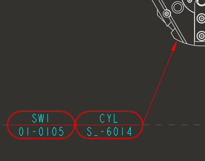

What I am trying here is to make controls BOM table from where all controls component (switches, cylinders, light curtains, safety gates, etc.) are shown and then ballooned in view. I am using "make flexible" to change controls_desc parameter that resides inside each purchase components. This parameter is shown on BOM as a description of controls component function. BOM balloon for this table will show fixture number (ex. 01-01) and will add 01, 02, 03, etc. to the end of fixture number. This is why I need "asm_name" because I want to extract fixture number. I know that if parameter is not in BOM table (repeat region) I will not be able to use it. And this sucks big time. So, I decided to put asm.name in column and "hide" this column by setting column width to 0.001 and text size to 0.001. But, to my surprise, when I called asm_name in BOM relation, instead of main assembly name I got name of the subassembly that resides within main assembly which I did not expect, because if I wanted that outcome I would have used asm.mbr.name or something like that.
As for your comment about deleting column and everything worked afterwards, I had the same experience. BUT! When I brought this BOM table to new drawing for new assembly it failed again! So, now, I am using your approach of manually adding fixture number. It is not repetitive work so I am fine with it.

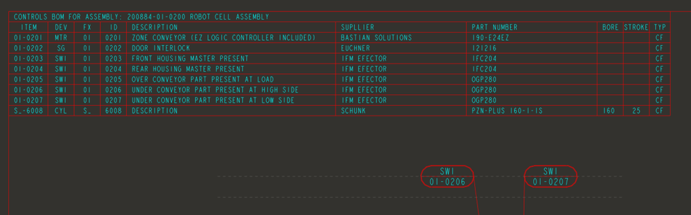

Here is how my controls BOM looks like:
Controls BOM tableControls BOM table
You can notice under ITEM column wrong naming in last row. This is because I am using asm_name in this case.

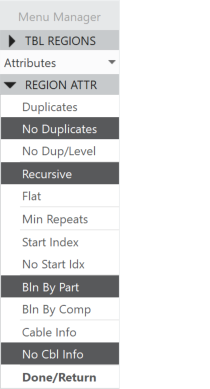

I set my repeat region attributes like this:
And I am able to even place balloons in view!
