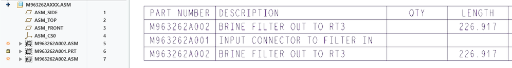

Hi BenLoosli,
I had created this table using assembly and included the components in it.
As you can see the tube part numbers are duplicated.
if i want to remove the duplicates and capture LENGTH and QTY information in only one row, the quantity of M963262A002 would become 2 and length would be doubled.
How can i achieve this ?
Reference topic: https://community.ptc.com/t5/3D-Part-Assembly-Design/piping-parameters-for-drawing-tables/m-p/735183#M119947
@PKUMARAK wrote:
Have already used that method, but lengths of duplicated parts are not merging in one cell.
That was the challenge I faced "how to merge the lengths for duplicated part numbers in one cell".
Am I missing anything or any correct method to follow?
I think you have to define repeat region relation. Something like:
length_sum = rpt_qty * asm_mbr_length
and in repeat region cell ... replace &asm.mbr.length by &rpt.rel.length_sum

There is a setting in the Repeat Region menu for Attributes and then set your table for No Duplicates.
