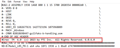

Using file manager, navigate to the file, RMB and use Open with and select notepad (or other text editor). It should have something like this in the header listing what version of Creo Paramtric it was created with.
