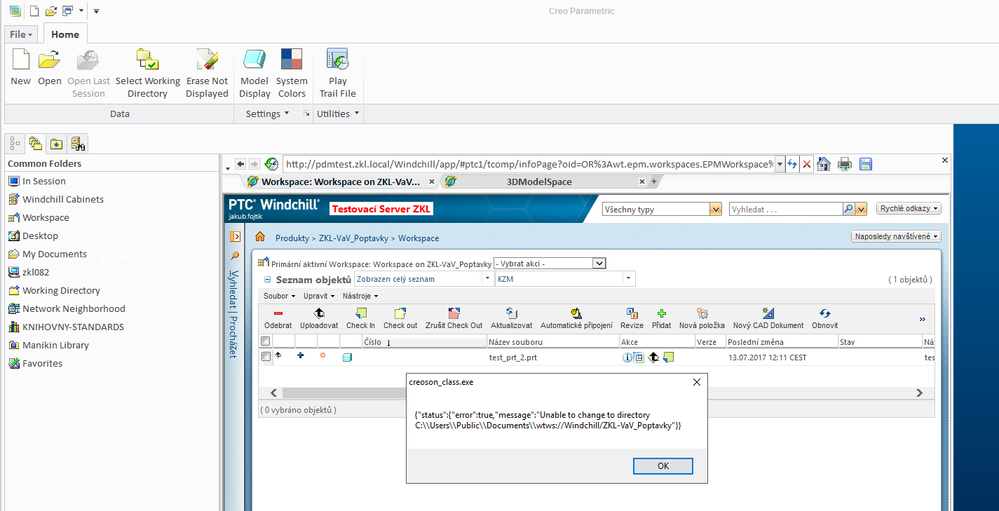

I've started writing my own CreoSON class in AHK. Try running the example bellow without lines 20 to 31 first.
obj := new CreoSON()
obj.creoSONUrl := "http://localhost:9056/creoson"
asmName := "large_assy.asm"
res1 := obj.connect(obj.creoSONUrl)
arr1 := Utils.ParseJson(res1)
sessionId := arr1["sessionId"]
res2 := obj.getWorkDirPath(obj.creoSONUrl, sessionId)
MsgBox, % "response 1:`n" . res1 . "`n`n"
	. "response 1 converted:`n" . Utils.BuildJson(arr1) . "`n`n"
	. "sessionId: " . sessionId . "`n`n"
	. "response 2:`n" . res2 . "`n`n"
	. "last status: " . obj.status
res3 := obj.openCADFile(obj.creoSONUrl, sessionId, asmName)
; look for "error":true in the response string
if inStr(res3, """""error"""":true") {
	MsgBox, % res3
res4 := obj.getBOMPathsFromAsm(obj.creoSONUrl, sessionId, asmName)
arr4 := Utils.ParseJson(res4)
Utils.Array_Gui(arr4)
ExitApp

I've tried to retrieve a model from a workspace using the following J-Link class and it didn't work.
public class RetrvFile extends DefaultUICommandActionListener {
     * Declaration of an empty field of a Session object type.
    Session session;
     * The following method works to override the OnCommand() method of the
     * UICommandActionListener class. The OnCommand() method triggers when
     * the user clicks the icon.
     * @throws com.ptc.cipjava.jxthrowable
    @Override
    public void OnCommand() throws jxthrowable {
         * Required: The reference to the session object. The method

Dave,
Can CREOSON open a model from workspace? I tried with CREOSON and it failed, could post that code too if you want.
~J

Notice the response shown from the MsgBox on line 24 on the picture bellow. In the code that is the line that says 'MsgBox, % res5',
Thanks.
~J
@James62
I think you need a CREOSON to do the following:
"windchill" "set_server"
"windchill" "authorize"
"windchill" "set_workspace"
THEN
"file" "open"
I think you are missing a few commands before trying to perform the operation.
Dave
hi Dave,
Thank you for the reply. Finally had a chance to try what you proposed and it worked!
Solution using CreoSON and AHK follows. I added a little gui to get user credentials.

Thanks, Now I wish I knew how to do the Upload of all modified objects in local workspace to the server-side workspace. Seems like CreoSON can't do Upload. The rest of Windchill operations I'd be able to do using Windchill Java API.
~J
Yea - CREOSON uses JLINK for the Windchill interface - so it is quite limited in this respect.
Good luck!
