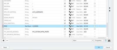

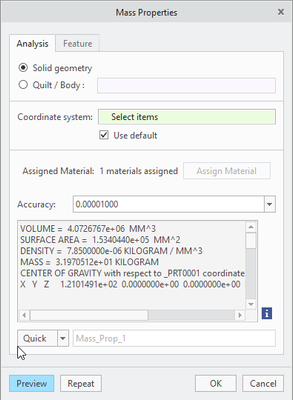

I remembered to measure the volume of the part, and change the density of the part. But I'm struggling with it.
I created a relation to calculate the density, according to the volume of the part, and the mass from catalog.
mp_density=catalog_mass/VOLUME:FID_VOLUME
But the final mass of the part, remains the default, don't know why, but I'm unable to change it.

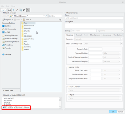

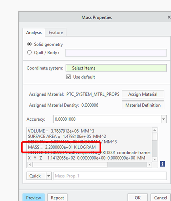

Found it!
I need to assign the PTC_SYSTEM_MTR_PROPS, and it works like a charm
