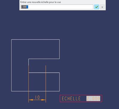

As you can see in the example below, I'm changing the scale of a view :
After clicking on the scale, this pop up appears :
My problem is that every time I use CTRL+A (normally to select all) when it is activated, this blue rectangle appears and changes what I type next.
This problem isn't only with the parameter &view_scale but any other parameters (&Material / &Scale ...).
How can I modify this short cut ?

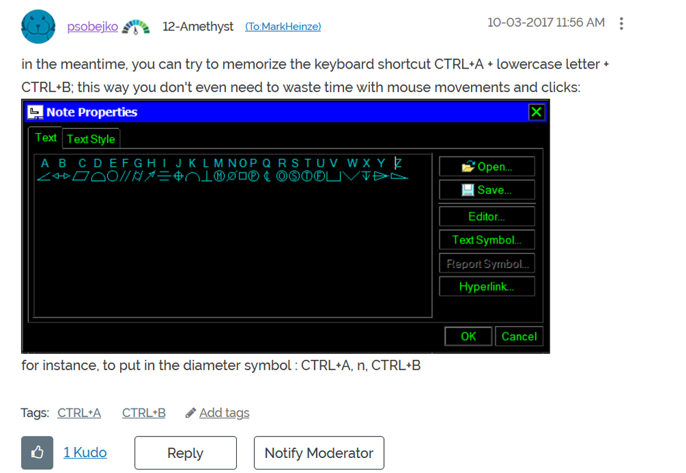

Using CTRL+B to switch it off will at least give me a great way to solve this rather than closing the entire soft.
Hi, here more information about CTRL+A and CTRL+B inside text editor:
