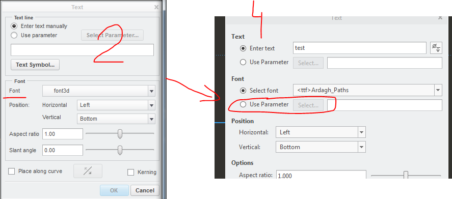

I wish to manage font height, content and font itself by parameters, but after few tests it only working well for PTC font types and no for TTF - does anyone know how to define TTF parameter (string) name? Or give me answer if this is working on not for TTF fonts?

SOLVED!
it is working but the font name must be simple (and perhaps not so long) and also equal to the file name.
String parameter with the name should contain only the font name without <ttf> on begining e.g. "Arial"
Test part attached with two parameters:
STRING - here you can put text you wish to see
FONTCHANGE - here put the name of the font you wish to use
