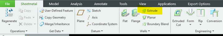

We are working on going from Creo 6 to Creo 8, and the first engineer I have testing the program has run into an issue. After you create your first Extrude, none of the options become available like Flat, Flange, Flat Pattern, etc... I'm in IT and not fluent at all in the actual modeling portion, so trying to figure out what might be causing this?

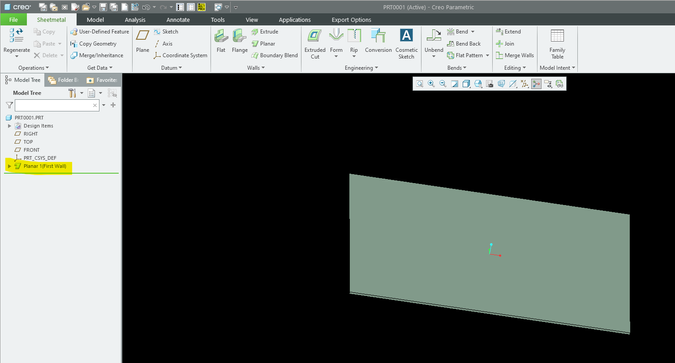

As per the image you uploaded, it seems user created the solid extrude (Not sheetmetal wall) which is not allowing sheetmetal tools to activate. User may activate the sheetmetal body (Expand Design Items in Model Tree > Bodies) and create a new extrude to have Sheetmetal option.

Mahesh is correct.  The first feature shown in your image is a solid extrusion and not a sheet metal wall.

This screenshot here pointed us to the issue on our side! We had a custom Sheetmetal tab that had the incorrect Extrude in it. They used the Extrude that was in the default Sheetmetal tab and it worked perfectly. Thank you very much for that screenshot.
