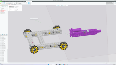

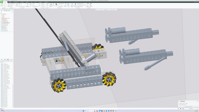

I'm trying to constrain a part, but when I go into the constraints, some of the parts disappear. I need to constrain to these parts, so any help would be appreciated.
