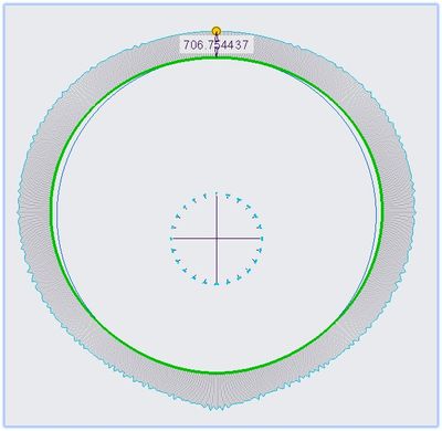

I recently opened a case to figure out why a slot follower connection through visually identical curves performed drastically different during dynamic analysis.  One curve was constructed as a curve through 360 points, the second through 3600 points, and the third was any approximate curve created by copying one of the other curves.  One of the things that case brought to light is the disadvantage of using curve through points or composite curves.  Both of these are generated using splines and the 2nd derivative used for calculating acceleration looks horrible.  R&D recommended only using 'analytical' curves,  specifically line, arcs, ellipses, and curves through equation.  Of course this doesn't work well when you're trying to create a slot follower connection and have to manually select 360 (or 3600!) line segments.  I still don't have a good solution.
Here's some of the stuff from my case correspondence:

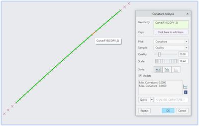

I did a quick test where I created a bunch of line segments between a small subset of the points and of course the curvature is non-existent (since each one is a straight line).
Creating an ‘exact’ copy of this curve also has no curvature because it replicates all the individual segments.

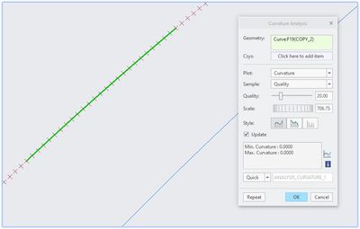

Creating an ‘approximate’ copy of this curve creates a single spline, but the curvature looks just as bad as the original spline.
I also tried reduced the point count from 3600 to 360.  It’s amazing how much smoother the curvature (and probably the 2nd derivative) is with less points, even though it’s still a spline.
Curvature of original curve with 3600 points (at the same scale):

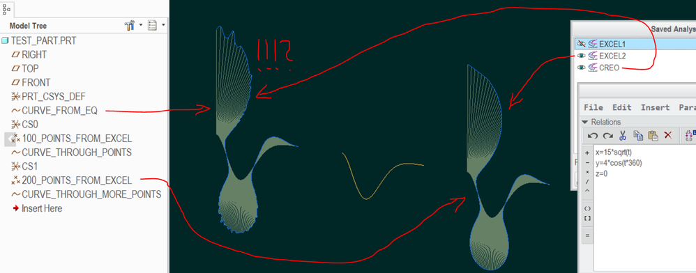

Interesting.  I thought curves through-points weren't so bad, and I'm surprised about the R&D suggestion for using curve from equation.  These are not well behaved in my experience!  I mentioned this a while back in this thread https://community.ptc.com/t5/Analysis/cot-cotangent-in-the-equation-for-Curves/m-p/546951 in which I show that the curvature graphs of the curve-through-points are smoother than the ones from the curve-from-equation:
Anyway, I think we can all agree that we don't have much of control over these Creo curves!
