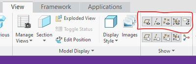

On the view tab, check that the datum are set to show.

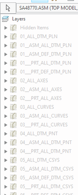

Also in the view tab, select the Layers button to view the layer tree.
Unhide the appropriate, or all, layers.

I would have never of looked there, thank you!!
