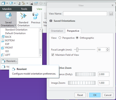

kdirth
(To:gmudlapur)
Reorient Perspective tab allows you to enter Perspective and adjust the settings.  Shift+MMB allows you to drag the model relative to the perspective point.  Ctrl+MMB+moving mouse up and down allows you to move in and out of model.
