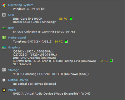

Hi Martin,
Specs are as follows:
I'm not sure if my graphics card is on PTC's approved list, but what's frustrating is that Creo's graphics and overall performance were perfectly fine up to version 10. I've tested Creo 11 and 12 on multiple computers where Creo 10 and earlier versions ran smoothly, but versions 11 and 12 feel noticeably choppy and laggy.
There are several issues: dialog boxes flicker when scrolling, selection issues, models lag or hang momentarily when opening, and selecting a component takes time before it's highlighted in the model tree. Overall, the program feels significantly slower and less responsive.
Creo 10 and earlier felt instantaneous
Graphics card
RTX 4080 Driver version - 32.0.15.7680
Intel (R) UHD Driver version -  31.0.101.5445

Graphics card drivers can "mess up" creo performance when windows updates happen, when creo is updated, hardware changes, or seemingly random at times.
You should experiment with different drivers.
Since it's a gaming card, it won't be on the approved hardware list so you won't get any help finding the correct driver.

unfortunately, your answer does not include information about whether you have tried:
1.]
config.pro option ... graphics win32_gdi
2.]
older graphic card drivers
My other tips:
a.]
test Creo 11/12 without custom config.pro files
b.]
disable GeForce and use Intel UHD, only (info my Intel UHD 620 uses driver version 31.0.101.2125 release on 24-May-2023)
