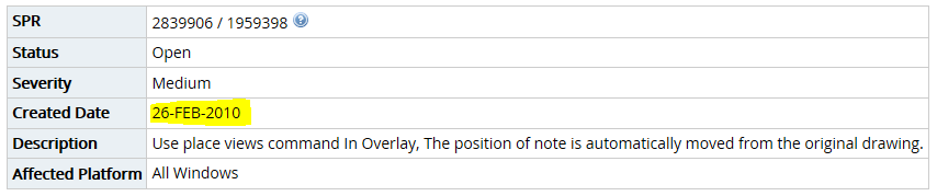

I've never used overlays before but a quick test didn't go well.  All of the notes and symbols associated with the view come along, but in the wrong positions.  (And with no option to hide or remove them, no alternate language versions of the notes an symbols could be used.)

This reminds me of another stupid bug in dealing with drawing locations. In creating a symbol one can use 'copy drawing' and pick sketched items, the coordinates of the drawing items are transformed to sketch coordinates, but with a twist. For example, create a drawing, sketch a line, and then create a new symbol. Pick the drawing line as a symbol element, and then finish the symbol attributes. Now, redefine the symbol and add that same line again. Is it a surprise what happens? Whenever I've tried this the line ends up with an offset. Repeating this process produces further offsets.
I have no idea exactly what the geniuses were thinking at the outset of the Detail package, but drawing coordinates seem to be built on a complex stack of relative scalings rather than the expected absolute locations, which often leads to problems being (wait for it) blown out of proportion. For real, they might be geniuses; I've never written a CAD package; however the drafting module is a really leaky model of drafting.
