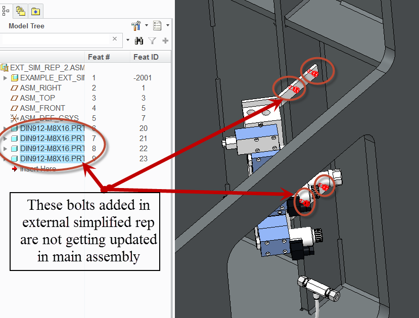

I am trying to add the component in the external simplified rep but the added component is not getting updated/visible in the reference assembly.
I am just trying to check if concurrent modeling is possible with external simplified rep.

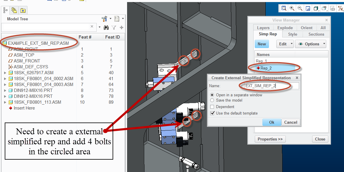

Sorry for late reply.
I am interested to know if it is possible for multiple engineers to work simultaneously on the large assembly.
Assume each engineer creating the seperate external simp rep and works on it independently and finally checks into the common space then will the changes made ( like component added or change in constrain type) in external simplified rep gets reflected or updated in main/ reference assembly.
Please see the attached document for better understanding.

The idea of external simplified reps is to create an individual simplified environment as an external "model". It is especially designed for the use with a PDM system (I doubt PTC has spent thoughts on concurrent engineering without a PDM system in recent years).
External Simplified Reps can be created in Creo and checked in or they are created directly in Windchill.
Of course the assembly and its components are treated as always: If you modify them you have to check them out and check them in later again. Other users will need to update their local copies.
The benefit is that you can have multiple engineers working on a large assembly, let's say a car. They can all work on specific subassemblies or parts and the external simplified rep allows them to do this in the context of the assembly, i.e. they can show the hood, when they work on the motor or show the chassis, when they work on the interior, etc...
To successfully use concurrent engineering, this will require some coordination and of course clever assembly structuring. Normally users will not work in the top assembly, but in subassemblies. yet it should be possible to modify the top assembly as well.
But I think in your case you added the parts to the external simplified rep instead of the assembly.
Try activating the assembly you want the parts to be assembled to.

Components or sub-assemblies that were selected from the original top assembly to be shared with the ESR - will be updated both in ESR an in the original assembly. Eighet when someone changes them in the top assembly contesxt or in the ESR context.
Items that were added directly in the ESR - below the list of shared items - will not make any change to the original top assembly.

A sub-component is designated from the assembly to be part of the ESR.
As far as I know, a component added to an ESR is not part of the assembly.
A component added to a sub-assembly of an ESR while in the context of the sub-assembly (while the sub-assembly is Active) will also show up in the assembly, when the assembly is refreshed, just the same as if no ESR was involved.
Yes, it is the evolution of *P8 above that is the basis of this discussion.
What does the (-v) stand for?
v= included by rep deinition
x= excluded by rep definition (or it parent assembly)
So in the original scenaro, those bolts have to be associated to an assembly in the top level and not in an ESR?
For instance, maybe a subassembly of the bracket that the bolts go into which can be referenced in an ESR.
The way they were added, they are simply a tool and therefore do not report back to the assembly.
Correct.
Some sub assembly that shared from the original top assembly should have been activated when added the bolts - and the bolts will show up there as well as soon as saved/checked-in etc.

You may simply look at the external simplified rep as the "new" top assembly (the top-plus-one assembly), which initially includes your "old" top-assembly as sole component:
  • If you add a new component to the "new" top assembly, it will be only in this external simplified rep
  • If you activate a component inside the external simplified rep (e.g. the "old" top-assembly), then you can make changes that affect this model
TomD.inPDX
(To:gkoch)
! Now that makes sense. A higher level assembly wouldn't report back to the top level.
