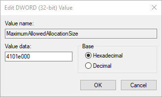

I have tried changing the registry settings suggest by
 CS103788
MaximumAllowedAllocationSize key as DWORD type in HKEY_LOCAL_MACHINE\SOFTWARE\Microsoft\Ole
  • Set the value as 01e00000 in Hexadecimal = 31457280 in decimal, 30MB
  • Set the value as 07800000  in Hexadecimal = 125829120 in decimal, 120MB
  • Set the value as 4101e000  in Hexadecimal = 1090641920 in decimal, 1GB
It did not solve the issue. Any ideas why Windows 10 1809 does th

If it helps at all, I am on Windows 10 1909 and it works. At first it didn't, but I added the registry value below, restarted Creo and it worked. I am using Creo 5.0.5.0.
