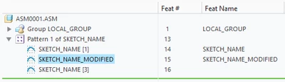

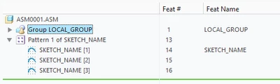

Is there any way to automatically assign the Feature Name (KE-Name in German) to every pattern element?
In the model tree it looks like the instance gets the parent's name with a [x] extension, but the real Feature Name is empty for these objects. (Of course, when I modify the instance's name by hand, it will be transferred to the Feature Name as well.)

@TB_9857665 , I don't know of any option in Creo that "auto-assigns" real names to the real-named feature that you pattern.  I suppose this should be a product-enhancement request.
As an aside, look at what happens when you pattern points - the software assigns real names to the pattern instances (though you have no control as to what those names will be ... )
Anyway, I am still not clear how you were planning to automate the layer assignment.
I assume that it would be with a layer rule that collects features that have a real name that starts with a specific string.
In that case, won't simply naming the pattern accordingly work for your needs?
For instance, if you you have a layer that collects features that start with "SKETCH1_":
renaming the pattern leader:
Renaming the pattern:
