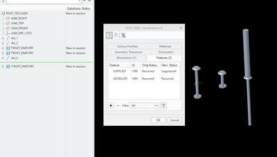

I have a rivet I want to show in an assembly. The rivet data was 'imported'. In order to show the installed/deformed position, I added a 'deformed' feature that can be controlled by a flexible dimension. The Master Rep displays the 'imported' rivet AND the deformed geometry. I created a Simplified Rep (INSTALLED) which displays the deformed rivet without the 'imported' rivet. So far, so good!
The flexible dimension will allow me to display a deformed/installed rivet for different panel thicknesses. When I add 3 flexible rivets into my assembly, I can change their dimension to fit 3 different panel thicknesses (0.75-inch, 1.00-inch, 1.50-inch). However, the display shows both the 'imported' rivet AND the deformed/installed rivet data. When I active the INSTALLED Rep, all 3 rivets default to the original dimension (1.50-inch) and do not hold their flexible inputs (0.75-inch, 1.00-inch, 1.50-inch).
Why won't a flexible dimension hold when changing the assembly to a simplified Rep?
Why do all 3 flexible dimensions default back to the Master Rep?
Can I apply a flexible dimension to a Simplified Rep only?
How can my assembly display only the deformed/installed rivet?

Yes, seems that flexible parts don't work well with simplified reps.
One way to do achieve your objective "How can my assembly display only the deformed/installed rivet?" is to re-define your rivet part so that it's flexible items table also includes the presence / absence of the "imported" feature.
Then for the installed instances, turn off that feature:

Has the suggestion from @pausob solved you issue?  The features tab in Flexibility allows you to do the same thing that simplified rep does.  Also, you can use distance for the flexible length to measure surface to surface to set the installed length.
