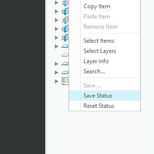

every time I open a particular assembly, I find some parts hided, in the principal representation and, every time I have to run the show all command (Ctrl+Shift+H). How can I show definitively again all the hidden parts?

Hi
You need to save the status of the layers after you have shown the parts in assembly & save the assembly.
