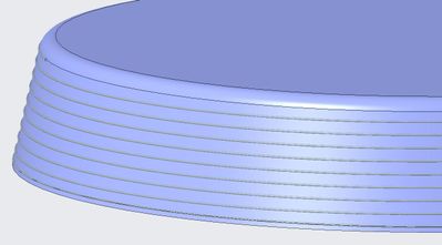

Can anyone help me?  I'm trying to create a spiral as shown but I need it to carry on around the radius of the surface and then up to the horizontal surface while still maintaining a constant center to center distance on the spiral.
If I understand your problem correctly, this can not be solved by only a variable section sweep. The geometry must be created in steps.
In the first example (spiral_03), the distance from center to center is defined by a point along curve pattern and is measured along the main surface. The spiral is defined by curve through points. The points must be selected manually and the option to place the curve on the surface can not be used (too slow and the spiral can only partially be created). Once defined, the main geometry can easily be redefined.
In the second example (spiral_04), the distance form center to center is absolute. The spiral is defined coil by coil. The distance is defined by the intersection of a circular sweep with the geometry. Each coil can easily be created using the copy, paste special option + advanced reference collector.

The easiest way would be to create a helical surface with a constant pitch that intersects the surfaces that you show.  You can use a variable section sweep with a vertical spine and trajpar in the section (to get the number of turns) to do this.

That's the tough part.  I don't have time to dig into it now, but it's in my head, so...  Again, without knowing what "pitch" to use, I can't even guess.
see https://learningconnector.ptc.com/content/tut-4159/using-trajpar-to-create-spiral-geometry video and investigate uploaded model.

Thanks!  I think this is exactly what I needed and I'm quite impressed.  I was also able to make some fairly significant changes to the spiral diameter and spacing and its very stable.  Thanks again!
