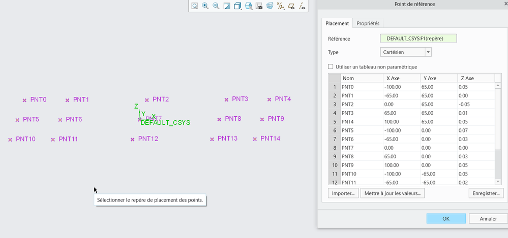

How to create faces with multiple points
I have multiple points like this :
And i would like to "visualise them" for a demonstration like this :
Is it possible ?
Thans in advance

One method would be to create straight curve through each point to form the grid.
Then if you need surfaces use a boundary blend to create flats on each segment. A little time consuming but it should work.

I had the same response to the problem that @Michael suggests. You might not even need the surfaces, if you're not going to be making any shaded images of the data. Besides, the four-sided surfaces won't really be very accurate as a representation of the "actual" surface you are measuring, will they?
If you've got lots and lots of points and the tedium is going to be too painful, you might want to look into external software that will turn this kind of data (a "point cloud") into facets. This kind of problem comes up a lot with topographical data, laser inspection systems, and the like.
If you're really ambitious, and the data is in a nice grid, you might be able to edit a copy of the points to build a suitable importable geometry file, like IGES or STEP, with the linear curves defined already. Or a program could be written to use the points to build the curves, etc.

If you are not familiar with .ibl file format, look into that format to generate the curves from the points. When importing the .ibl format it will produce curves in Creo. Be advised that these curves are not native features so are not parametric features but it seems like this would not be an issue for your scenario.
How to import .ibl files.
https://www.ptc.com/en/support/article/CS107337
This is an example of the .ibl file syntax. You can create them in a text editor using the points from your metrology report.

This file creates 2 sets of curves, each with 3 curves. The values contained are the x,y,z coordinates

@KenFarley  , not sure if you are asking about the relevance of the .ibl or making a general comment about how to automate the creation of surfaces to generate the "facets". It is not clear to me if surfaces are needed in Creo to solve the problem as presented.
Based on the photo of the report and the graphic shown there; The .ibl approach would use 10 curves defined in the file. The .ibl file does not define surfaces, only curves. Using 10 curves defined within the .ibl format can generate the same grid view shown in the photo.

I definitely would want to do something with the .ibl format file because of its simplicity in terms of getting the points into a format that yields the curves. I was, as you suspect, also thinking about how to parse through the list of points to define single two-point linear "curves" that would be the edges of each of the grid  elements shown in the original inquiry. I love using .ibl files because it's a nice tidy text format that you can work with easily, as opposed to the somewhat convoluted IGES or STEP files. I've used them for redefining surfaces that had massive problems with discontinuous curvature, etc.

You can’t create a surface through this 4 curves?
If the curves are line segments and not splines the surfaces would be created automatically as far I remember.
You have the same number of points for each curve, so this should be easy. This is what Michael mentioned!
