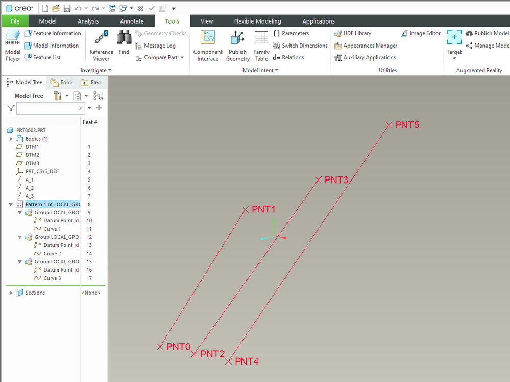

I have a number of individual points that I would like to pattern with individual pattern tables and then create a curve thru a point in each set of pattern points and then reference pattern those curves to the table pattern points.
Is this possible and how?
In the picture below I have created 2 offset coordinate system points and have patterned them separately using separate pattern tables.  I then created a curve thru the 2 points I created and then referenced pattern the curve. the pattern of curves should be separate straight lines.  For example the second curve should be going from pnt1 to pnt10 and not from pnt1 to pnt9 and so on.
Any ideas on how to fix this issue?
my ultimate goal is to use a family table to swap out the pattern table to change the position of each row of points.
Thanks for any help you may provide!

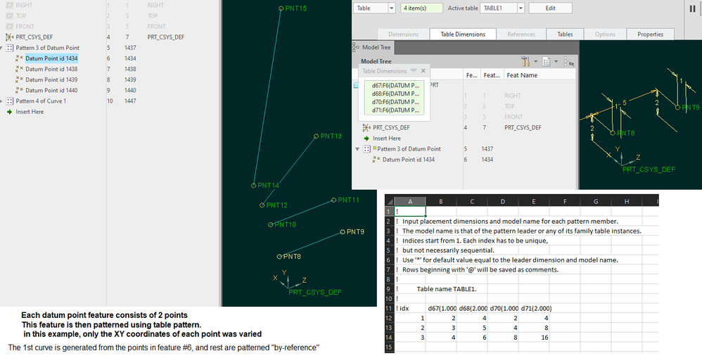

Creo 7 model posted for reference.
This appears to enable the goal to pattern the features as described. The model uses offset from csys datum points to define the proximal and distal ends of the curve that will serve as the pattern leader. A curve through points is created for the pattern leader. These two features are grouped and then patterned using the pattern table functionality.
This is an alternate way to implement the desired curves mapped to the points by using datum points offset from csys rather than a just pattern table. I would not use a family table to modify the model, but it may work for you.

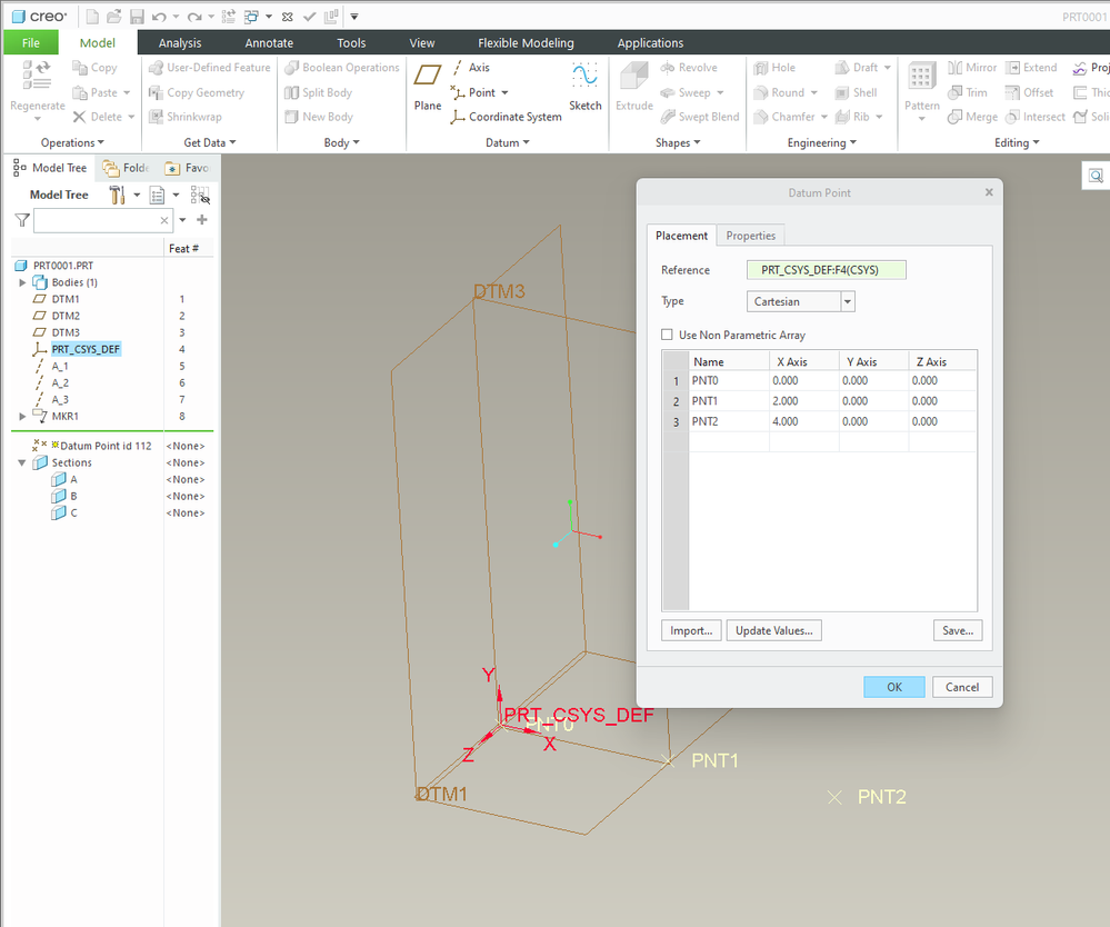

Note that you can import the coordinate values if you use an offset from csys datum point array feature. I would import .pts files used by the datum point features to update the model rather than a family table. There may be a way to avoid the pattern table altogehter and use the offset point array only but I am not seeing as of now. I will consider it again at a later time.
About Datum Points Offset from a Coordinate System (ptc.com)
This is using a pattern table to add sets of points and curves as pattern instances and can be extended to N curves as required. The pattern table is used to add the coordinate values of the proximal and distal points of each curve instance in the pattern.
Offset from CSYS datum array with table entry. Note the option to import the coordinates.

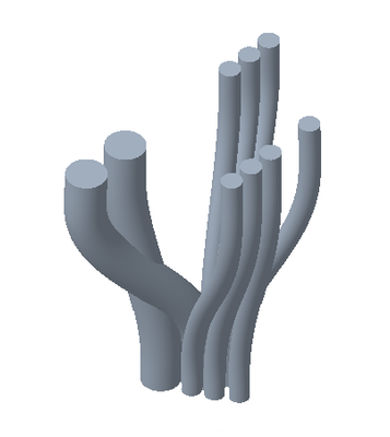

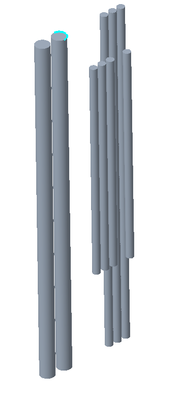

The component model I'm trying to make has wire leads that start at different locations at the top of the image below and will have straight wires for the component drawing with 2 wire lengths. I need to be able bend the wires in a curve and bundle them in a circle along with staggering the ends of the wires so the component may be spliced into the harness at the assembly level. The other need was to have the point clouds for each section tied to a coordinate system so the routing of the wire may be changed at the assembly level for the component. Note the component wires will be tied to a Creo Cabling harness at the assembly level.
I will try and share more images once I have the models more complete.
