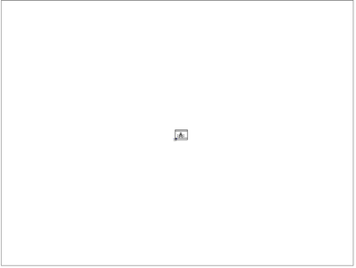

Everything is normal for my created Simp Reps, the Refit is fine and gives standard size of view. However, for the Default Rep and Master Rep (in which all parts are included), Refit pushes models far far away, just like in the attached screenshot. Is there anyway to fix this issue?
Thanks for your help.
I turned on datum plane display, and found one sub-assembly has abnormally large sized datum plane. So I opened the subassembly trying to fix the datum plane. However, the datum plane size is actually normal inside the subassembly. Weird.
I switched back to the top assembly, and weird again, this issue disappeared! It was not a glitch, because it was not fixed by itself.
