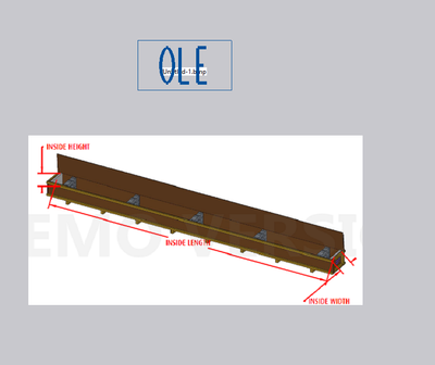

As I recall, importing image in Notebooks was possible in the past. Currently, there seems to be an issue with it. Sometime importing a jpg might pop up, but most of all you get a frame showing 'OLE' and the imported file name, but no graphics.
I can't seem to figure out what the root cause is. Importing an existing JPG file as an object seems the only way to do in a notebook, while a drawing has a specific Images import command

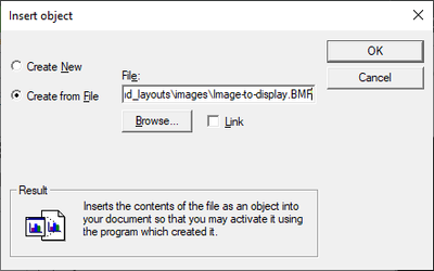

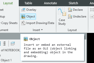

Using this procedure imports the graphic content into my layout just fine - though seems only BMP files (24-bit?) are supported:
then

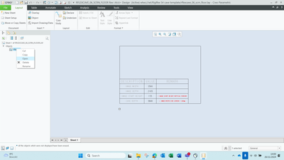

Another way I am suggesting to try - is to bring in a new "Paintbrush Picture" object:
This will open MS-Paint window with a new image - into which you can paste whatever content you want..
After closing the MS-Paint window*, the image will be shown on the layout.
* Note there is no need to save the image - behind the scenes, it will be saved as a 24-bit BMP as the MS-Paint window is closed.

BMP doesn't work, the Paintbrush Picture work-around though will work actually!
To be honest, this probably does what I need. No further sophisticated stuff needed. Still wondering how I did in the past though...
there is a new update: though the paintbrush option works, when switching Workspaces in Windchill and coming back, the picture is gone!
It now shows a white dot on the page and the object is still visible in the Objects list. In which I can select and edit it in Paint. but not visible in the layout page
