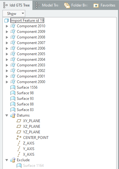

Helo,
I have imported an Inventor assembly but the Datums, planes, axis etc. there not visible.
Is there a procedure to make them visible in the model tree?
Is there any other more proper way to import the files?
Thank you in advance
Apostolis
Solved! Go to Solution.
Can you check to see if the datums are hidden on a layer? If it is, unhide the layer and save the layer tree status.
Also, you may just want to make new datums based on your preferred coordinate system. The ones you have are collapsed into the import feature and won't be accessible from the model tree.
