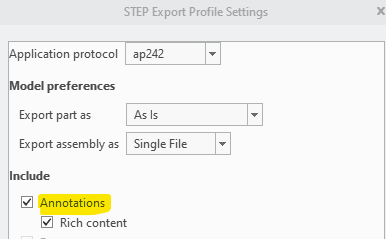

Hello All,
In Creo 7 when saving as a STEP, I was able to select the coordinate system in the window shown in the attachment but in Creo 10 the button stays greyed.
Does anybody know why this is ?
Most likely because you are exporting annotations. Uncheck exporting annotations in the step options.
Thank you, did the trick
Good find, @Chris3
This is documented in CS445647 and CS289898.
